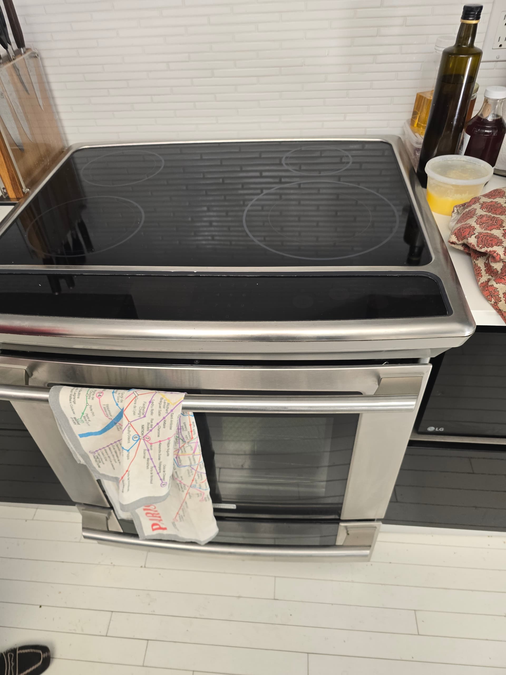

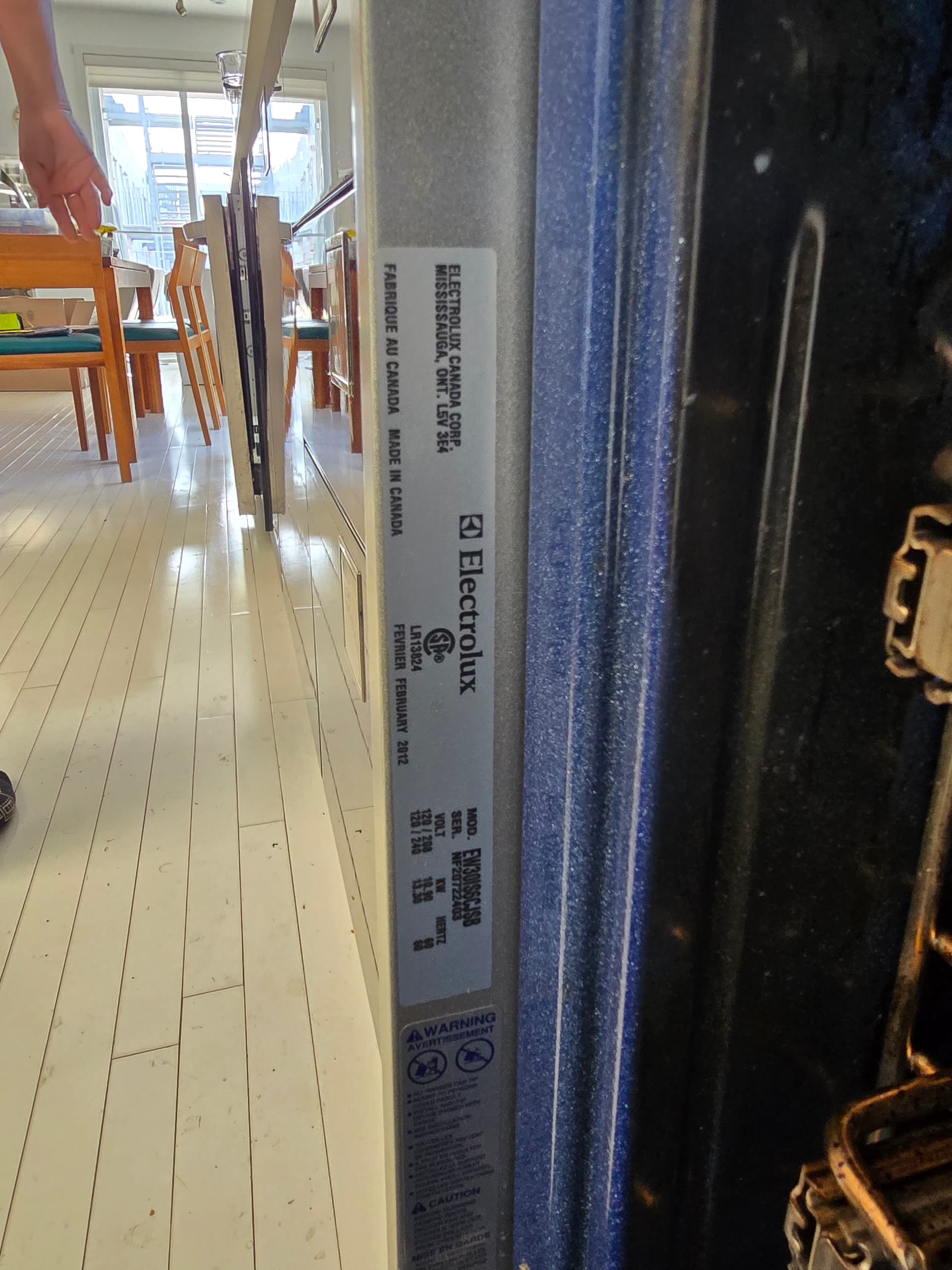

Hi, I have question about electrolux induction stove Model : ew30is6cjsb There is no light on the display [ oven & induction ] There is 240$ on terminal box Is it this part problem 316443916 power supply? [ the wires coming from the terminal box go

But even the display for induction not working also ; not lighting
Is it one display for both?? Oven & induction
Yes, The control board behind the control panel will control the burners and the oven. The membrane switch which is the control panel connects to this board and controls all of it.
