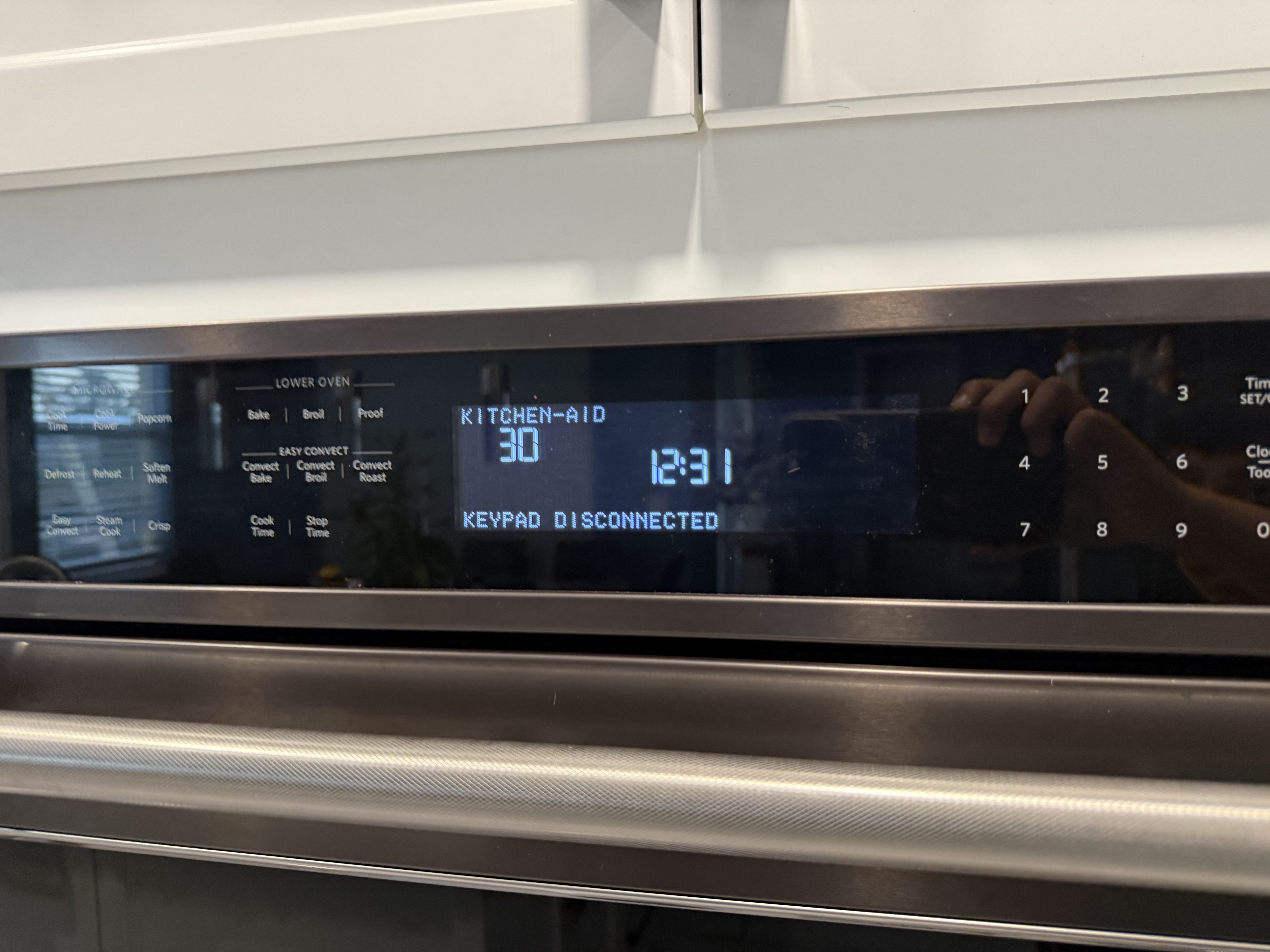

Help with Code 30 "Keypad Disconnected" on KitchenAid KOCE500EBS20 - Control Board already replaced
Brand: KitchenAid
Model Number: KOCE500EBS20 and Serial Number: DB1013971
Main Symptom: KEYPAD DISCONNECTED AND UNRESPONSIVE

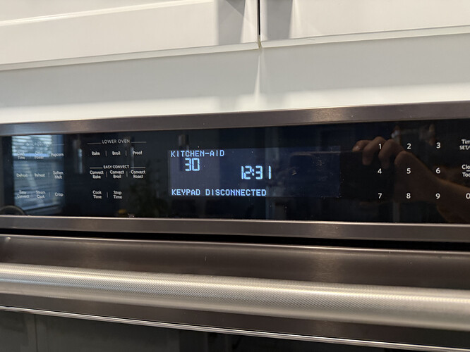

What happens & when: The control screen displays “KEYPAD DISCONNECTED.” The entire touchpad is unresponsive to all inputs. It is a single, integrated screen for both the microwave and oven functions.
Error Code (if any): 30 / “KEYPAD DISCONNECTED”.
  1. Confirmed the ribbon cable connection is secure at both ends.
  2. Replaced the main microwave control board with an OEM replacement (Part #AP6872126).
  3. After the board replacement, the error code “KEYPAD DISCONNECTED” persists exactly as it did before.
  4. The parts diagram for my model lists two separate components:
    • 12A: Oven Control Panel Overlay
    • 12B: Microwave Control Panel Overlay
    Since my unit uses one single, integrated glass interface/screen for the entire system, I need to know which of these parts is the actual electronic touch interface that includes the ribbon cable for the screen. I do not want to order a cosmetic trim piece by mistake.
    Can anyone confirm which part contains the touch-matrix ribbon cable for the KOCE500EBS20, or if there is a specific “Console Assembly” part number I should be ordering instead?
    Thanks in advance for the help!
Photos/video link:
If anyone can help, I would appreciate it very much.
For the actual touchpad assembly with overlay
  1. White ( Whirlpool W11600635 Control Panel | Genuine OEM Part )
  2. Stainless Steel ( Whirlpool W11600634 Control Panel | Genuine OEM Part )
  3. Black and Stainless Steel ( Whirlpool W11600633 Control Panel | Genuine OEM Part )
Thank you very much!
