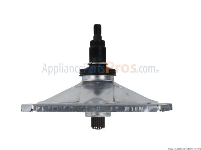

Hi Jeff, thanks for the suggestions. Would the shifter assembly be the “Washer Transmission for MVWB835DW4”?
I did move the washer and found what appeared to be a bunch of dark greasy material splattered in a circular patter on the floor (travertine tile) and I see it all around the bottom of the dryer. Attached is a pic of the floor.
Nope.
The only item with oil/grease is the tranny/gear box :frowning:
LINK> Washer Transmission OEM Part
Check for a leak down the middle of the washer…tub seal may have been leaking water into the tranny/gearbox causing it to throw some oil out…this would be a worse issue.

Thank you for the input! I’ve started the disassembly work and am stuck with the washplate removal. Used an impact wrench to remove the 7/16" nut, but the picks I have are too small and the washplate won’t budge. More to follow . . .
Jeff, the washplate came out after a bit of WD40 was applied and got the transmission out. The piece of wood and mallet suggestion to remove the transmission (from the Appliance Parts Pro video) did not work. I had to hit the transmission a few times directly with the mallet to get the transmission out. Once out, I inspected the tub and found stripped/damaged teeth on the gear at the center of the tub (see attached pic). Replacing the tub + transmission = “buy a new washing machine”. Thank you so much for the help! Too bad Maytag washers are not as durable as they used to be. Cheers!
