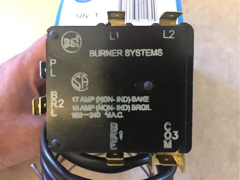

I have a Whirlpool oven thats been burning everything we try to bake lately. After doing a bit of online research and speaking to Whirlpool’s parts distributor I’ve come to the conclusion that the oven thermostat is the most likely culprit. The parts distributor said that the original part (Robert Shaw Part#RAC12-133-48) has been discontinued and replaced with BSI Part#6700S0011.
Since the parts aren’t the same some of the labels are different so I’m not exactly sure which wires go where on the new part. L1 and L2 are easy but the others are a bit confusing.
Thanks in advance :slight_smile:

I’m a bit confused though.. I can only hook up 1 wire for the pilot light on the new control.. it doesn’t have multiple prongs like some of the others. Also, shouldn’t anything connect to COM? It allows for up to 3 different wires so I find it odd not to get any.
The new control box did come with a basic sheet. I forgot to include a picture of the wiring schematic in my original post.
Here you go:
I think the middle diagram is the one we need.
Notice how all three wires bake, broil, and one side of pilot connect to the “common” terminal.
Your new Thermostat has three spade connectors on its common terminal.
Connect one side of each of the bake (red), broil (blue), and pilot wires to common (com3)on the new t-stat.
Connect the other blue (broil) wire to brl2.
Connect the red (bake) wire to bke1.
Connect the other end of the pilot light to pl.
That should do it. Make sure the push-on connections fit snugly. Loose connections generate heat.

I have the same problem. I followed these steps and the oven will not heat (bake or broil). The pilot light doesn’t light either.
Replaced a Robertshaw RAC-12-133-48 with a Exact Replacement Parts Inc. 6700S0011 thermostat kit. Any help would be appreciated!
6700series> I have the same problem. I followed these steps and the oven will not heat (bake or broil). The pilot light doesn’t light either.
Same here. Then I checked the 30 amp fuses with a multimeter. It turned out one of them was bad even though it was not obvious, did not look “blown” on visual inspection. I replaced that one and now the oven heats. I’m using the “old” thermostat, the one I thought was broken.
