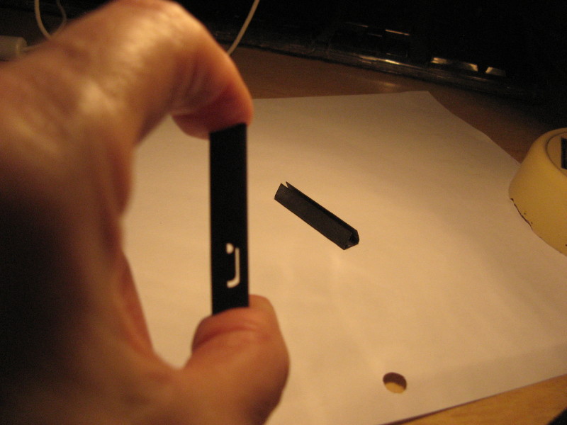

Also, when I took the inner door panel off, two small metal shims (I think they’re shims) fell out, but I don’t know from where. They are each about 1.5 inches long, open triangular shaped with a little clasp-thing in part of the middle section. i can’t for the life of me figure out where they go.
I put the new glass in and replaced the inner door panel. I can see that the shims probably prevent a person from screwing the two top long screws down too far, but where do they belong?

Can you post a pictures?
Here are the best pictures I can get. Each “shim” or metal piece is about 1.5 inches long. Thanks again.

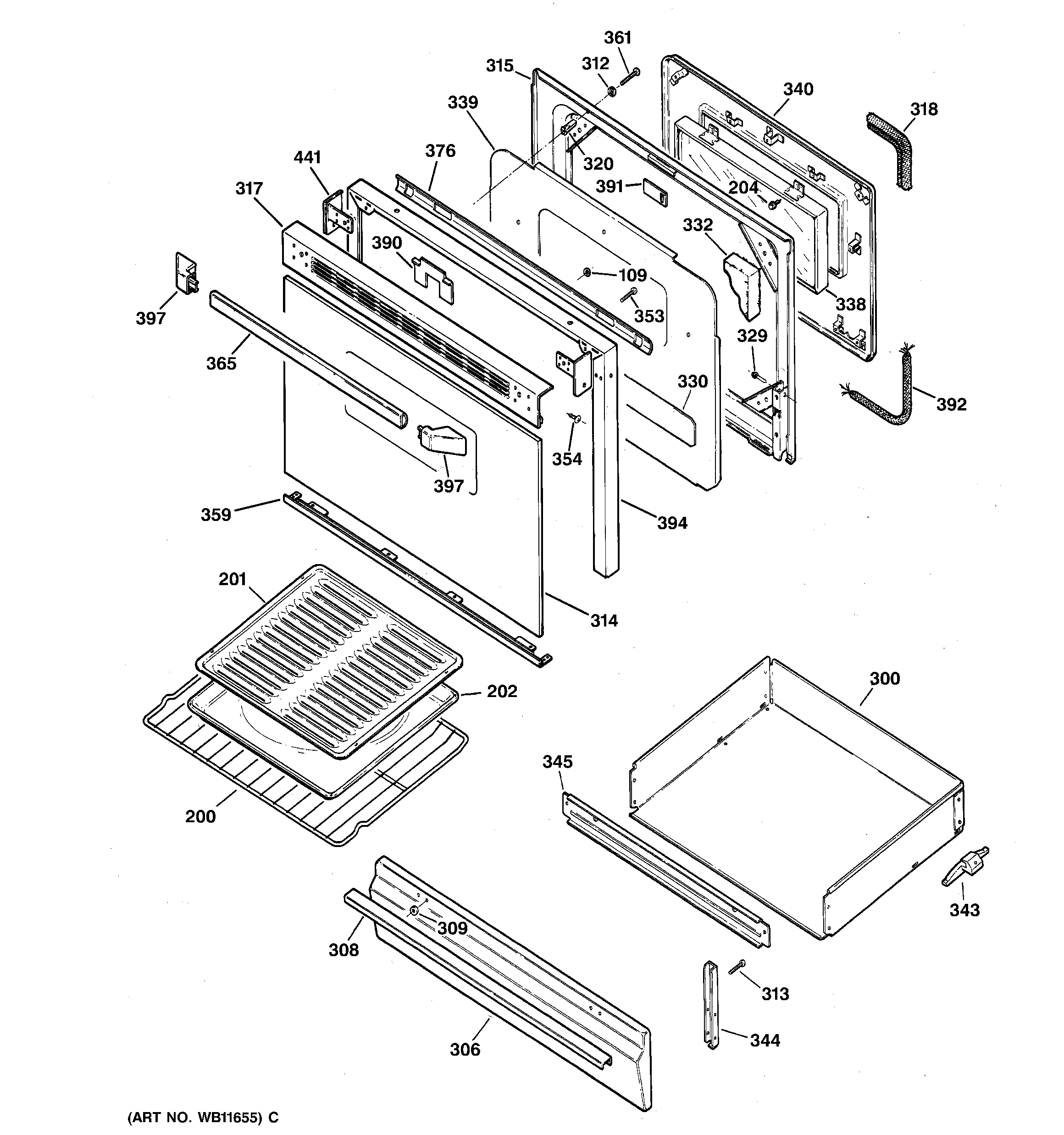

[QUOTE=pjensen100;63187]…two small metal shims (I think they’re shims) fell out, but I don’t know from where… I can see that the shims probably prevent a person from screwing the two top long screws down too far, but where do they belong?..[/QUOTE]
GE calls this part “spacer”, and you are right, it should prevent these screws from being over tight. These spacers are shown as #320 on the diagram.
Thanks a million!
You are welcome.
