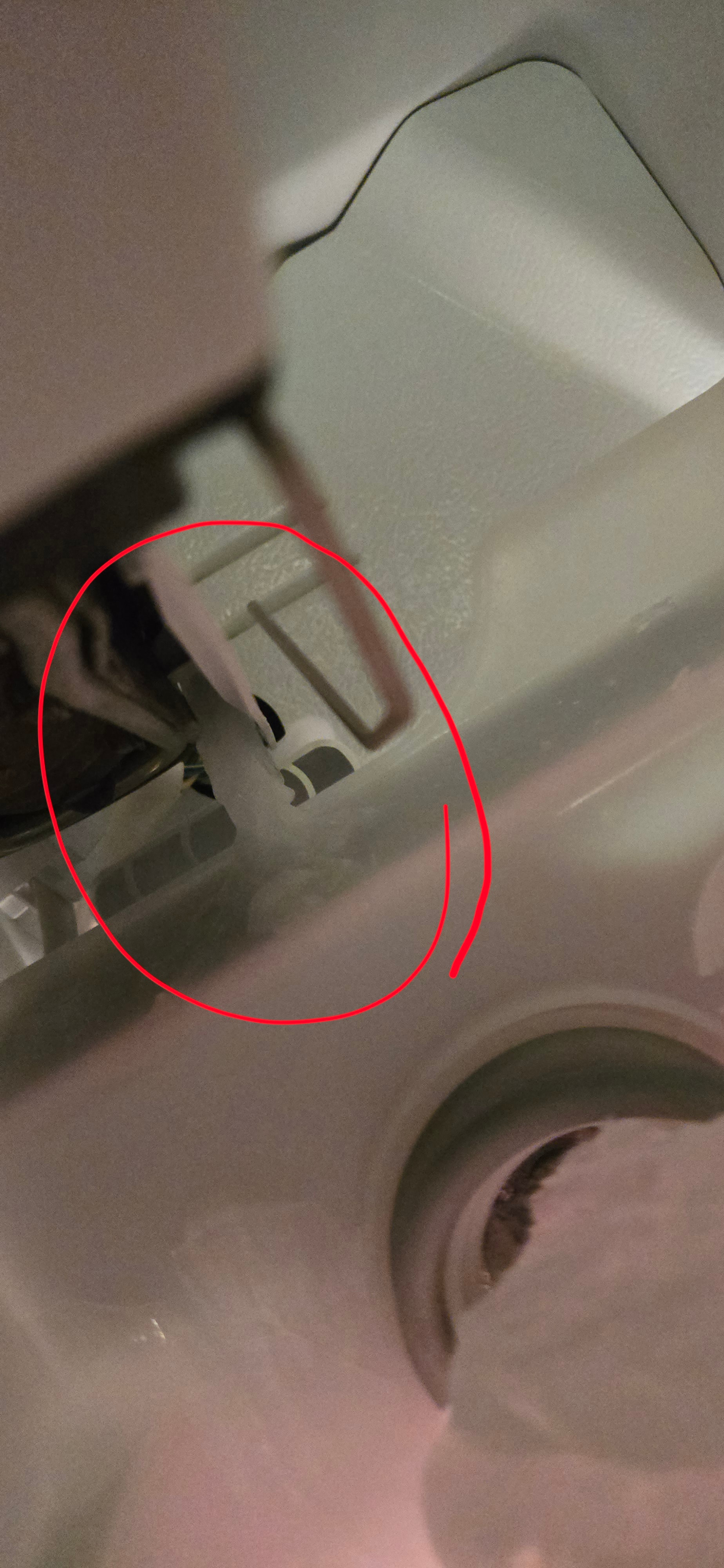

Help figuring out what part i need
Brand: frigidaire
Model Number:lghs2665kf0

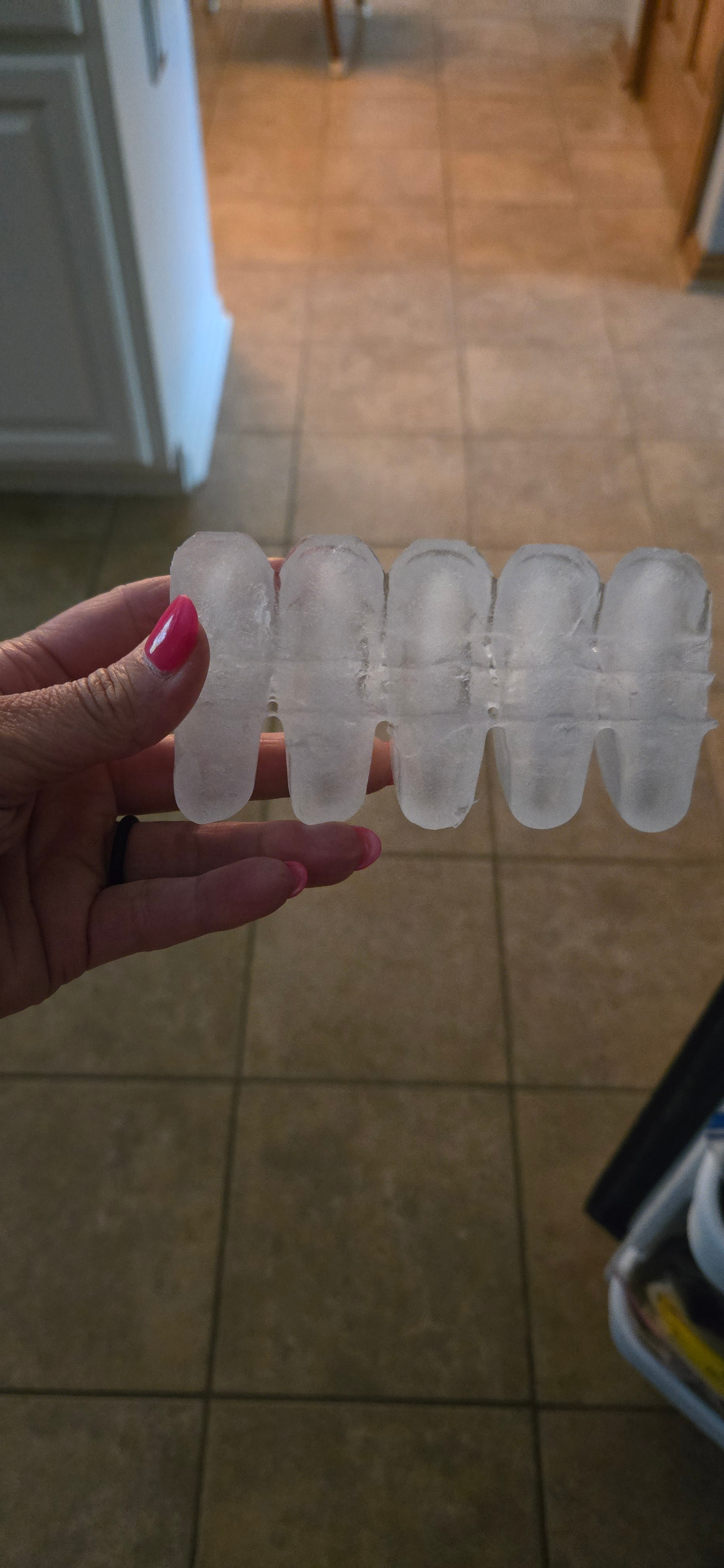

Main Symptom:ice maker is over filling with water making oversized cubes then knocking when dumping
What happens & when:knocking when dumping cubes.
Hi branducurry5179,
It sounds like you may have a bad water inlet valve. As a quick test, try turning down the water pressure slightly at the shutoff valve and see if that helps.
More than likely, though, you’ll need to replace the inlet valve if the issue continues. Also, if your ice maker has a fill adjustment screw, try turning it slightly toward the minus (-) side to decrease the amount of water entering the ice maker.
