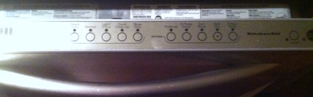

Glad to find such a helpful forum, but couldn’t find any posts that addressed my particular issue:
Dishwasher cannot be run as there is an error at the panel:[LIST]
  • motor is okay
  • can enter cancel / drain mode
  • have tried unplugging
  • learned that reset codes exist and tried some random combinations, which enabled me to run the dishwasher, only to have it fail again. Reset it one more time, now can’t get it to reset any more (but I don’t know the actual codes.)[/LIST]Current panel lighting description:[LIST]
  • no lights blinking
  • heavy duty, quick clean up, rinse only can be selected
  • start will not light up or activate on any of these though
  • cancel is selectable
  • heat dry / lock will light up automatically when heavy duty is selected[/LIST]I have seen comments in other posts that are different brands and models about reset codes, ribbon replacements, control boards, heating elements, etc., but don’t know where to start.
I can also add (though this may be irrelevant) that my wife likes to put a small amount of vinegar in cycles to keep spots off the glasses. She doesn’t do it every time, but probably more often than needed.
It’s four years old and has many nice features and a stainless tub, so I would hate to replace it. I also don’t want to dump a ton of money on parts and repairs and service calls. Advice, troubleshooting, diagnostics are greatly appreciated!
Dave
Kitchen Aid KUDR02FSSS.JPG (25.4 KB)

Ok, so I opened it up and could see that there was corrosion on a couple of the white connector wires, seemed to be P-3, P-4 or in that block. I wrapped the exposed portions in electrical tape to see if I could restore the connection. Sealed it all back up, plugged it in, and all the lights on the control panel were active. Loaded a few dishes into the dishwasher to run a cycle as a test. By the time I was ready, it was already shorted again.
So I’m under the impression that the wiring is shot on these and potentially some other connections.
What would you recommend at this point? Purchasing parts for replacing all the cables & harnesses? I am guessing that is more cost effective than a replacement, though I am uncertain as the remaining life span of the unit.
By the way, I wanted to mention that this is unit KUDR02FSSS3 - sorry for leaving the final digit off…
