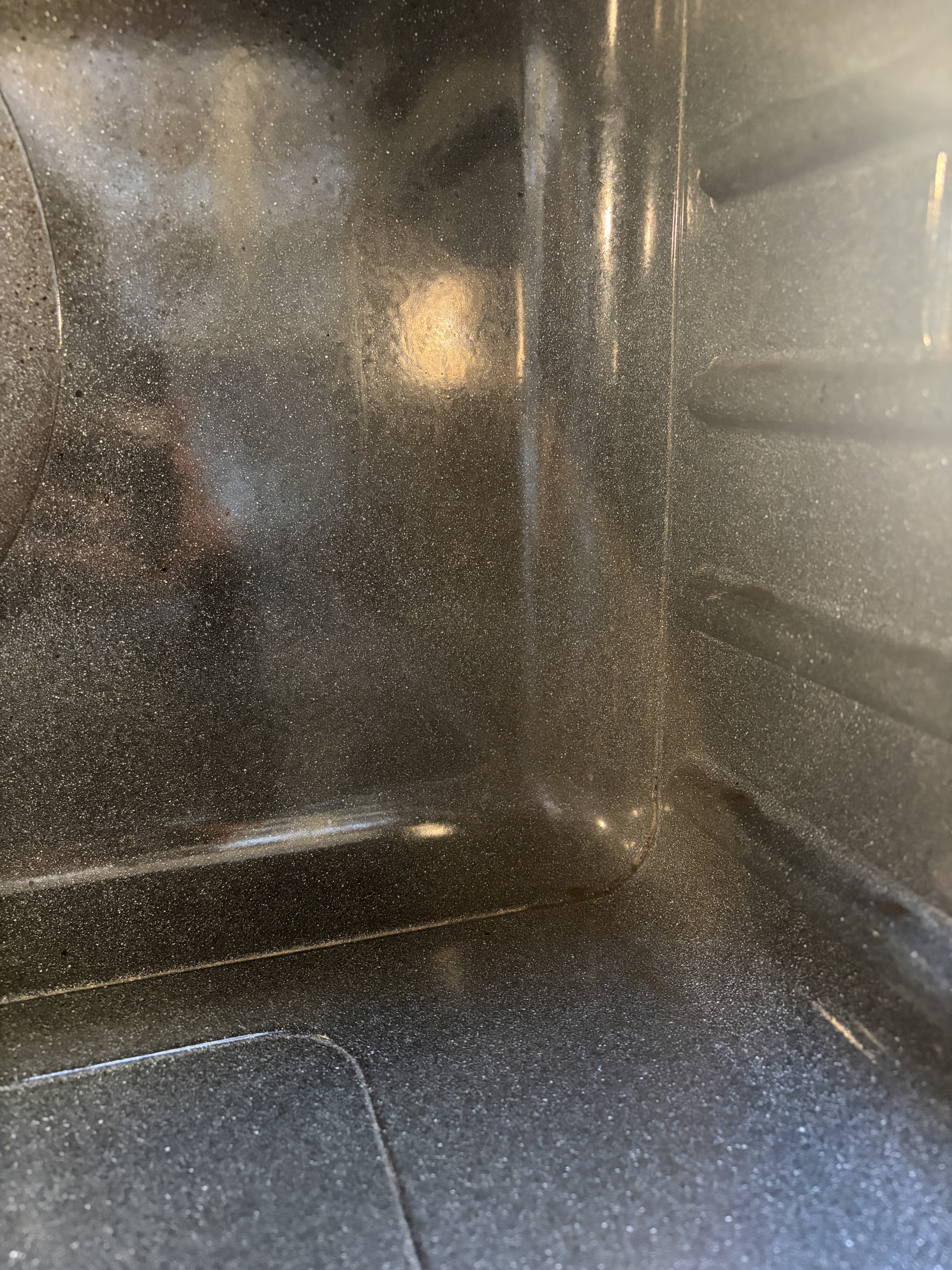

This is my friends oven and i’m not there till tomorrow. Since it’s friday, i’ll relay what I know and saw. I looked before I began job and didnt see screws, but will look again. I did pull oven and shields from the rear and even removed 2 screws holding element in place. I believe those screws would not have been accessible to me from inside the open oven floor. Could there be an overlooked alternative? In the meantme I’m having my friend look for the screws in rear of oven floor. Thanks
This is pic of rear corner, seamless floor. Thanks
Then it must come out from the rear was there an access panel to the heating element on the rear
I wouldn’t call it an access panel. Nothing like I see on the videos. More like dismantling a large part of the oven. The horizontal squirrel cage is the most obvious block, and the screws to undo it all all facing skyward, unable to be reasonably unscrewed. Beyond that there are still panels blocking. I would think the element would have a reasonable removal and replacement
