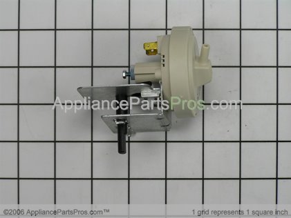

If you look at the water level switch picture bellow
you can see three terminals. How are they marked?
P.S. Unfortunately I do not have the wiring diagram for this washer.
