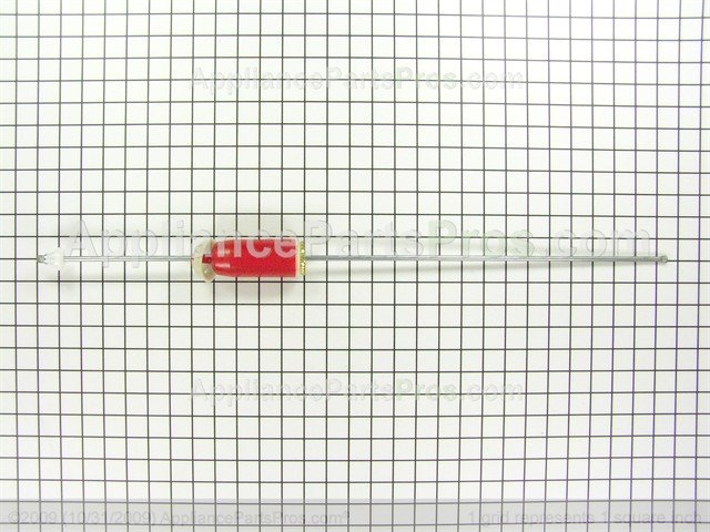

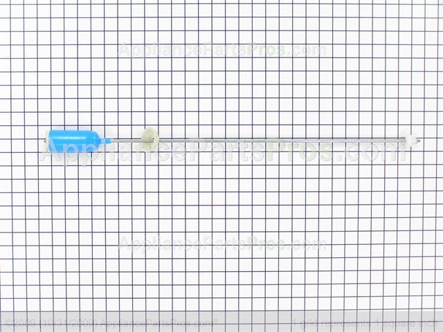

Possible t he suspention springs are allowing the basket assembly to drop down too much.
LINK> Rod and spring X2
LINK> Rod and spring X 2

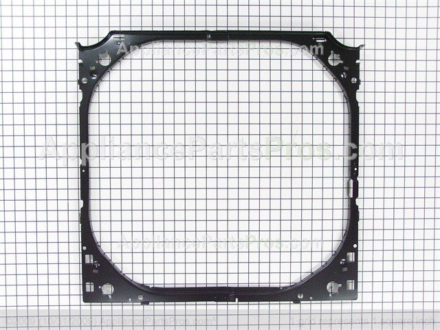

Next is sometimes the top of the cabinet weakens and allows the top frame to sag down and the bottom of the basket assembly hits the base.
Says NLA now :frowning:
LINK> Weld Asm Rod Support
