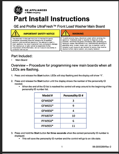

Thanks for the reply. This is a new control board. It was replaced March 2025. Machine purchased new in October 2020. Everything worked prior to February 2025 when the machine started having issues. It eventually locked up mid-cycle, and would not drain. I had repair guys from Thumbtack come out and diagnose it. They said failed main control board and replaced it. Machine works but as mentioned, the LED does not work. Not sure what to say about error codes…but that is what the machine is throwing when I go through the codes. According to the GE app, when the main control board was replaced, it showed up in the app as GFW650SSN2WW, which I was told is similar. The personality code appears to be set correctly as well. Thanks.
Just to cover all bases—do you know which personality code was set into the control during installation? That can affect how the appliance functions and is worth verifying.
Here is the personality codes for that part # Control board WH22X37840. Was it set right?
Personality code 4 would be the correct one. If personality 4 was used during the installation process, the failure would be in the main control as referenced previously.
