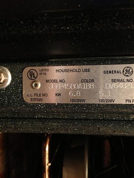

I have model JKP45OA1BB. Are the instructions the same? I took apart the top (control unit) and could find the BAKE1 wire. I am assuming that is the BK1 you are referring to. I do have voltage on that wire. I cannot find a BA1 wire though.
Hi.
Please, check the model number. Could it be JKP45BA1BB?
Simon.
Here is the model number: J KP45BOA1BB
It is a wall installed double oven.
[ATTACH]5737[/ATTACH]
Here is a picture of it.
Model Number.jpg (42.6 KB)
Hi.
You have a different control board it’s WB27T10282.
What it the original problem. Please be more detailed.
Simon.
Yes. I have procrastinated for a year but I finally determined the control panel is bad for oven #1. No voltage out of BAKE 1. So I ordered the recommended part in this thread. Only upon inspection, i have a problem, the old control panel is part #wb27t10055 has been replaced with the new control panel part #wb27t10283, which is the part suggested here and confirmed by GE. Only the connections are slightly different. I am an electrical engineer and am comfortable making connector mondifications, but I cannot find any wiring diagrams to show me how.
