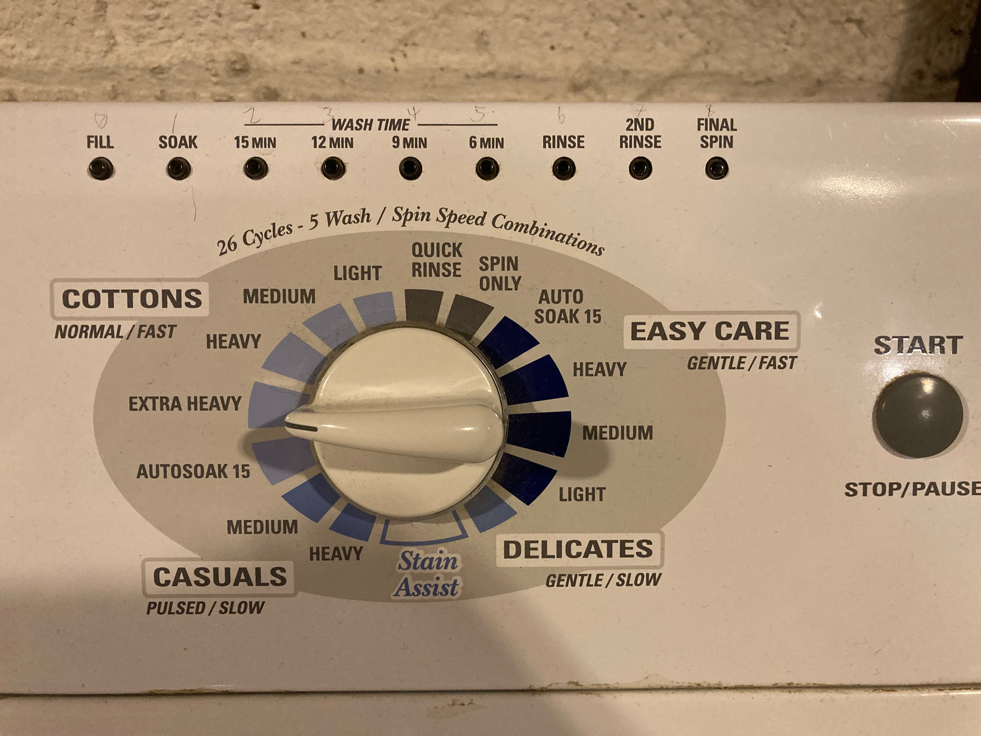

I had the tech sheet in the machine and ran the diagnostics a few times to - I think - pair up the LEDs with the table.
First image is the Field Service Mode table. To the left are the lights that were lit up per click of the knob. The checkmarks on the left means that the machine went to that item/cycle upon next click. Hot provided hot water and cold provided cold water as expected/hoped. There wasn’t (?) a setting for Warm. LOL, this must’ve been reprinted 4 million times as the resolution is terrible!
Second image is the dial where I numbered the LEDs in pencil.
Not sure if this matters, but why this caught my attention was that (with the old valve) the Hot setting would fill with mostly hot water, but occasionally switch to warm (to cool it a bit, I guess); the new valve fills with hot water only (and it’s HOT!). Same when it was set to Cold (occasional switch to warm). It’s almost like there’s a thermostat somewhere that’s not functioning any more.
Appreciate your expertise!
