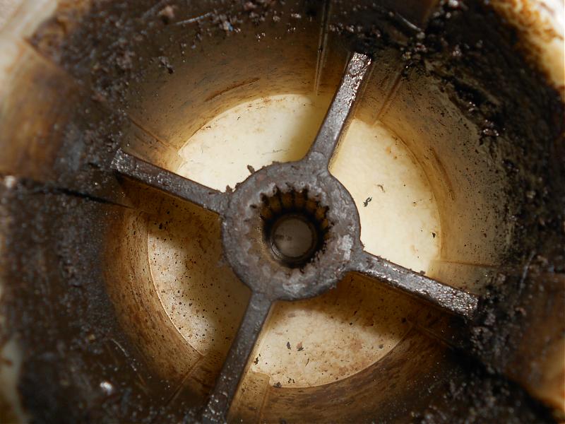

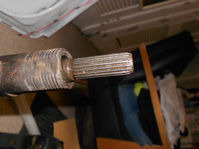

You are such a huge help, this is great. Thank you so much. Results of transmission test: Turning the pulley/belt clockwise results in the entire transmission turning (whoa!) but turning it CCW it did just what you said it would, the part of the shaft with the teeth on it would slowly turn one way and then turn back the other way as I continued.
Perhaps the videos and pictures I saw with stripped couplers were extreme cases and mine is just bad enough to be bad? I took pictures of my drive shaft and coupler for you to check.
washing machine 001.jpg (47.4 KB)
washing machine 007.jpg (38.6 KB)
washing machine 010.jpg (67.1 KB)
Looks like those splines inside the coupler are worn down. Should look like this. Try placing the coupler on the shaft and then rotate coupler forcefully by hand. If it rotates independent of the shaft, then it’s stripped out.
Eric
Well I’ll be…I just stripped it further doing the test but yeah that had to have been it. I thought there were enough teeth to catch and I had an employee look at it too. Compared to the online image of a stripped coupler she agreed that ours didn’t look stripped (but neither of us is trained in motor repairs). I could be angry with myself but I think that finding that bad water seal made all the extra work worth it; that looks like it could have caused serious problems in another year. (I can post a pic if you’re curious).
