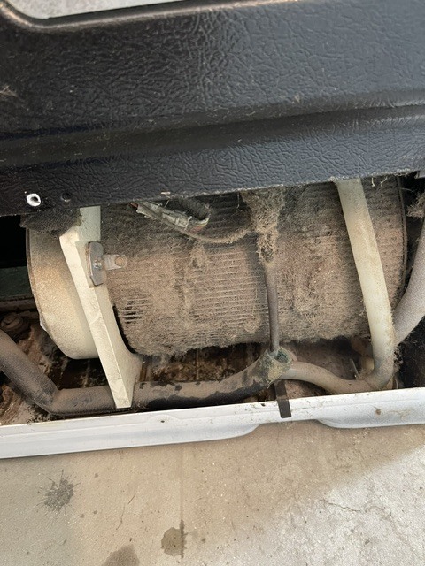

First, just an FYI that the fridge has been unplugged and at room temperature for about 4 days now. I took the back cover off and saw that the baffles on the
condenser fan motor were caked with crud. You can see from the attached picture. I vacuumed the condenser fan motor as best as I could. I noticed that the pan at the very bottom had sitting water to about the bottom of the drain tube. I used a shop vacuum to suck up all the water, then tested the drain tube to verify that water was flowing freely on to the pan.
Yeah That could have been a big part of your issue as well
Ok. I’ll put everything back together and plug it back in and see if that does it. Thank you so much for your help!
So you’re sure that defrost drain to the pan under the fridge is clear?
Yes, it seems to be free flowing. I didn’t mention earlier, but the very bottom seemed to be blocked by some styrofoam, which I removed. Not sure if that was an issue.
Are you still having the issue?
I put everything back together and plugged in a couple of days ago. So far everything is working as it should. We will see in a few weeks if the problem returns.
