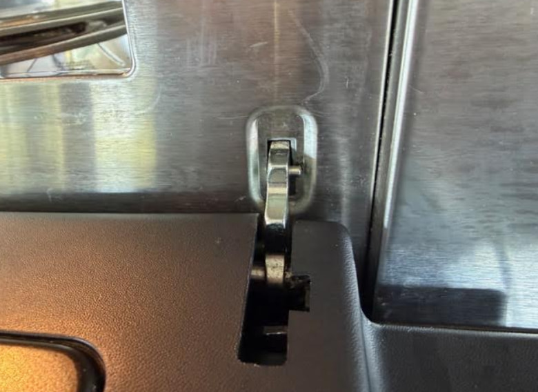

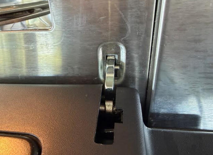

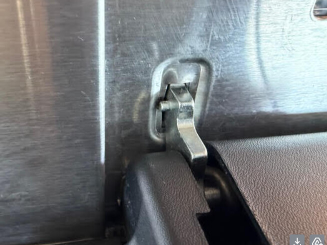

GE PSB2201NSS Main door comes off
Brand: General Electric
Model Number: PSB2201NSS
Main Symptom: Door comes off easily
What happens & when: Hinges pull out of door. Looks like pin should be behind front face.
No error codes
No parts or tests tried.
The pin on the hinges are supposed to be positioned like in the image. When the door is being closed, do the hinges wobble up and down in the receptacle, and do the hinges feel like they are not closing as well as they use to? The hinges are supposed to have a door lock inserted into the door to provide a block so that when the door is closed a few degrees, the block allows the hinge to rotate with the door for removal. If the hinges are stiff, it can cause this issue. One thing I do see is it looks like the left hinge receptacle seems to be bending outward, which is a potential for allowing the hinge to have more freedom than it should.
