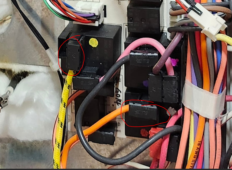

If you access the small relay board at the back of the range, set the upper oven to bake, and test from the orange wire with black stripe at the DLB relay K7 to the yellow wire with white stripe at the bake relay K18, is there 240 Volts AC when the oven stops increasing heat? This is to identify if maybe the upper oven high limit switch has weakened and preventing the oven from heating up more.

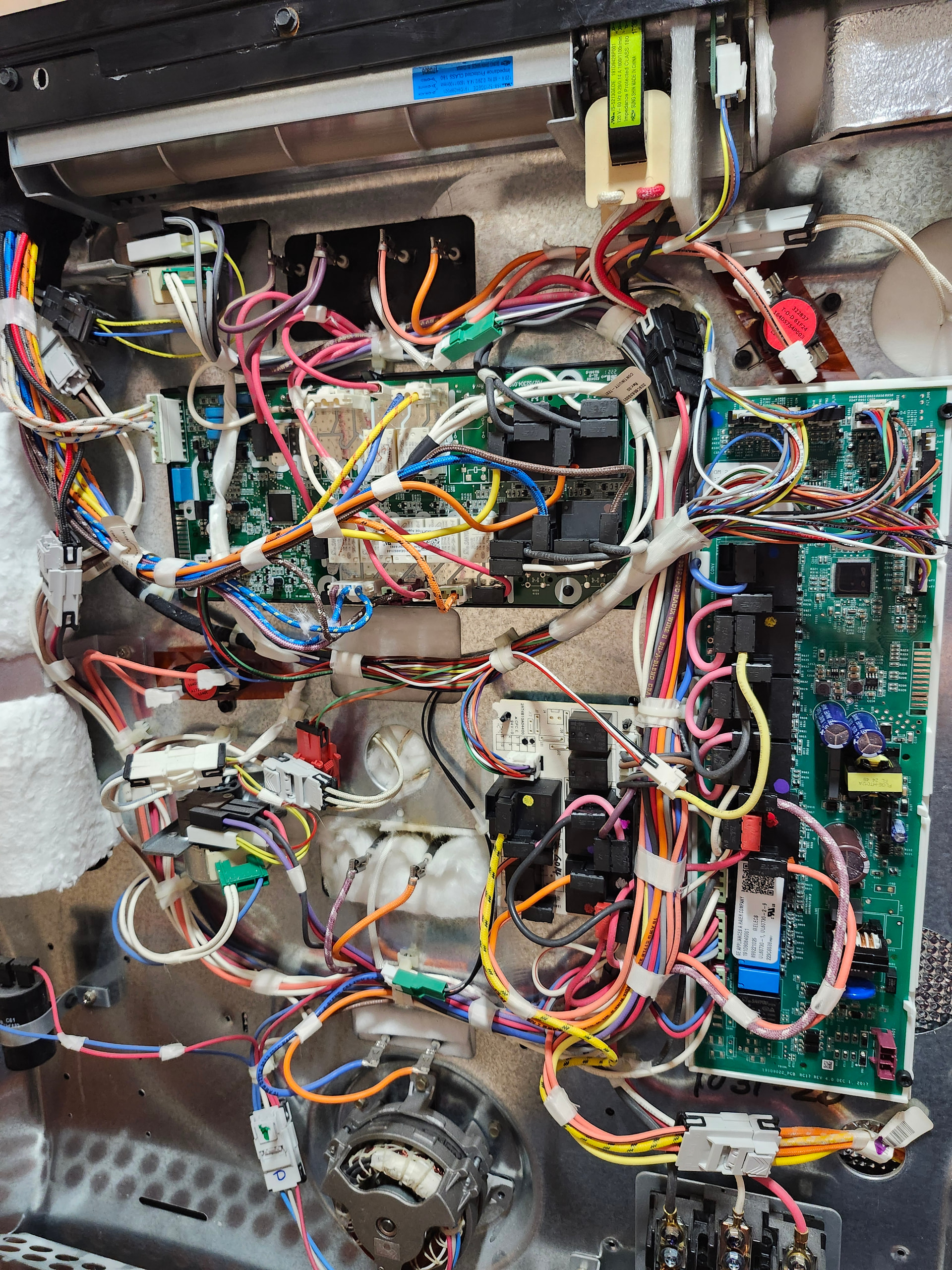

You will have to help me out here. Can you point items out on the included picture?
Here is where you would want to test at.

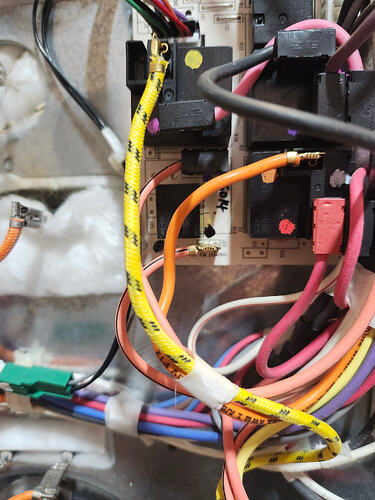

I finally found a wiring diagram. Of I am reading it correctly, the wires may not be connected properly. My diagram indicates J24 should have a solid orange and J23 should be orange and black. If you notice fron the picture, J24 is orange and black and the DRM DLB COM is solid orange. Should those two wires be switched?
If the orange wire with black stripe at J24 is going to the high limit thermostat, it would need to be switched with the solid orange wire. Have these wires been removed before?
I am not aware of them being removed before. I did switch those 2 wires and the oven preheated to 350 in about 12 minutes.
