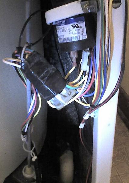

:slight_smile: Eric, Taa Daa! Problem appears solved, but not the path we expected. As soon as I touched the wires near the relay one of the double yellow ones going to the capacitor spade connector popped out, showing a burnt end. I suspect the repetitive action of the moving tub support around which the wire bundles are wrapped, combined with a very short wire from the relay to the rigid capacitor so it had no wiggle room, a factory installation that had the relay literally supported by the double yellow wires going to the capacitor, and the factory forcing two wires into a single-wire spade lug so one was not fully crimped, gradually caused one the yellow wires to flex and the strands to break individually until there were a few strands left. Those few chose this week to go Poof. The body of the relay does look a little cloudy inside, but no sign of burned contacts. I did some imagineering as I retaped the wires so that the relay weight is supported by the wire bundle coming down from the top of the machine, yet everything is free to move as much as the support rod can move. Once the yellow wires were repaired, I measured 3200 ohms from white to yellow at the motor plug. Next, all the functions passed in Service Mode. We just completed an uneventful wash load, which is a good thing. Happy --happy — happy!
The photo is pretty much as I found things when I went to see about the relay and discovered the broken yellow wire, except the capacitor bracket was tight. It’s a wonder the wire didn’t break long ago. I also noticed that the tape was quite chafed where it contacted the rod support at the bottom, so I reinforced that area.
So thanks loads — pun intended — for your knowledge and assistance to stick with me thru this. If you will send me your mailing address, I’d like to send a token of my appreciation … or at least make a charitable donation in your honor. Thanks again. Steve
6-13-13 Broken wire to capicator-2.jpg (40.5 KB)
That’s a sloppy install job by the GE technician. The capacitor and relay are not part of your original washer. It was required and added at the time of the installation of your new motor. He should not have wrapped the harness around the tub support rod like that. That rod gets a LOT of movement during agitation mode. The top of the relay should be facing upwards to protect the terminal connections from any water splashover from the tub. Anyway, good job on getting that fixed. No need for any donation. Always glad to help a DIY’er get their washer repaired. Especially those like yourself who have a clue what they are doing.

I stand corrected on thinking the factory did this botchery. I figured the wiring was installed that way at the factory to make sure it didn’t get near the blades of the exposed water pump that is directly beneath the capacitor. I’d love to see a photo of a factory installation — if the capicator, relay and water pump are in the same proximity — to see how they did the wire routing yet stayed away from the pump fan while allowing sufficient wire harness movement without putting a strain on anything. I wrapped the wiring harness around the rod similar to the way I found it — I just made sure the wires to the capacitor did not carry any weight, and kept the capacitor from rotating by taping it to the harness from the top of the washer. Now that I know what a mess I really had, I’d like to redo the wire routing while it’s on my mind, and totally unwrap the wiring harness from the support rod … if that is the intended method. Do you have a photo of a GE washer that shows that routing?
The original motor in your washer is no longer available which is why they offered the new motor with install kit. That kit includes the new pigtail wiring harness, capacitor and relay. The harness gets spliced into the old wiring and capacitor and relay get installed in the front cabinet. In newer washers that came from the factory with the new style motor, the capacitor and relay are installed inside the user control panel at the top. So there is no “factory” install of these components in the front cabinet. It’s up to the technician to get it right. Here’s a couple photo’s of one I did last year. The relay is taped to the new wiring harness in the upright position and the new wiring harness is tie-wrapped to the old one above the capacitor. The new wiring harness goes behind the suspension rod once where it is taped to prevent chafing. This is the way the original harness was routed. There is plenty of slack in the new wiring harness between where it comes from behind the rod to where it is tie-wrapped to the pump wiring above the cabinet clamp so that there is no tension at all on the wires attached to the relay and capacitor when the tub support is swinging during agitate.

[COLOR=black][FONT=Verdana]Thank you for those photos. A far cry from what was done to the wire routing here. I untaped everything & rerouted per your photos as best I could without recutting anything. I did a couple of things differently. I attached the tiewrap near the motor from the top, which placed the harness well above the tie rod bracket. (I attached it from the bottom yesterday and it had already pulled out of its hole). I ran a new tiewrap thru a hole that’s an inch above the capacitor mount so it would prevent the capacitor from rotating, which it wanted to do no matter how tight I got the bracket screw. The tiewrap also went around the relay, which now points up, so that will stay put. No more strain on any connectors and plenty of wiggle room for the harness. As you can see from the photo, it’s not as neat as yours but should be more than adequate. Thanks for everything. If you ever get near Greenville, SC, look me up. Dinner’s on me![/FONT][/COLOR]
