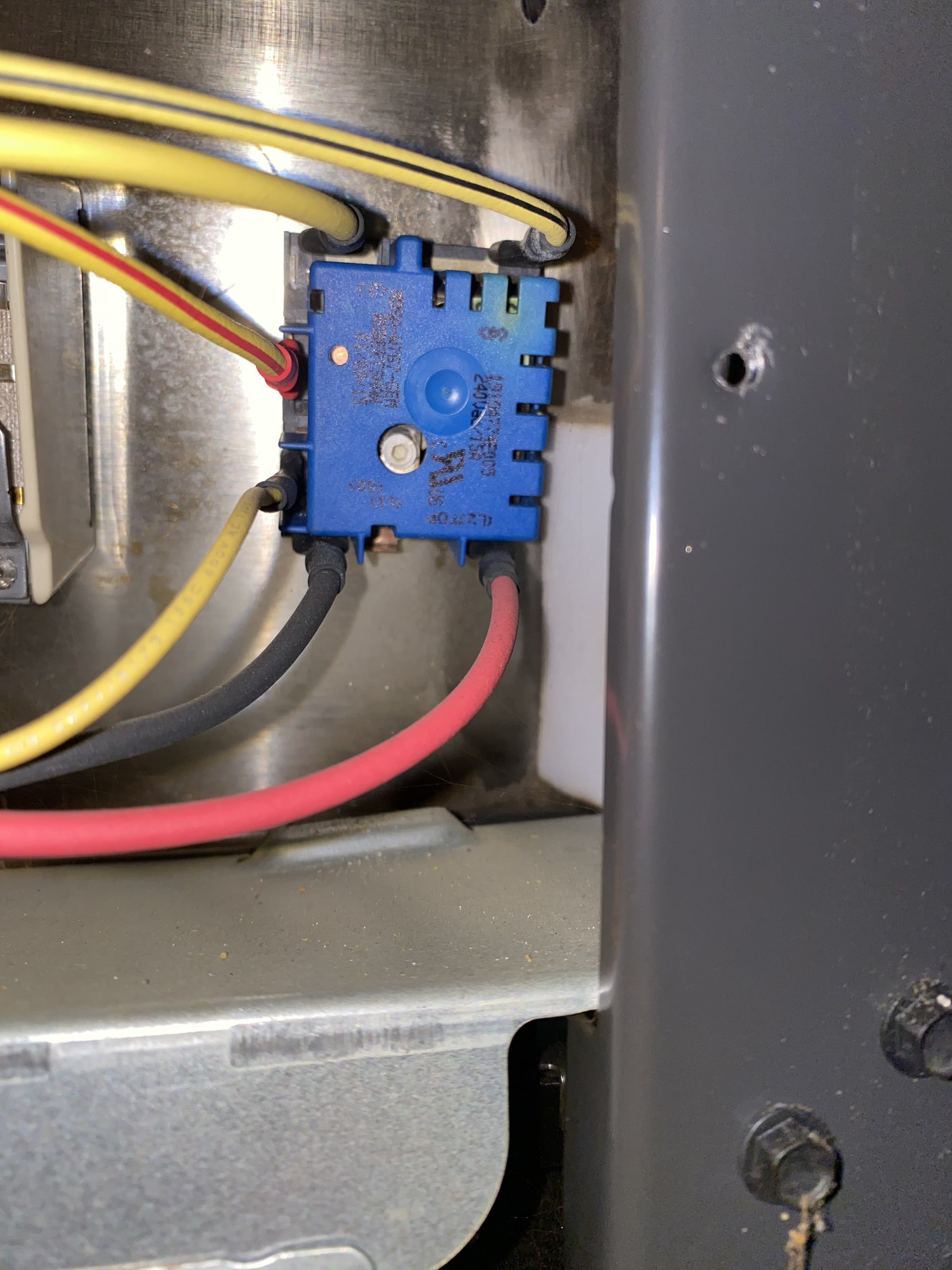

GE Profile Replacement Part Differs from Original
Brand: GE
Model Number: PB930SJ1SS
Main Symptom: no temp control—always on HI
What happens & when: Everytime turned on for small or large burner
I ordered the correct part for my model. That part # is WB24T10146
The problem is the original part has 6 wires, and the new part has only location for 5.
How do I wire this?
Pic attached of the original part.
I believe the diagram on our site is reversed the part # you need is ( GE WB24X47186 Range Infinite Switch Control | Genuine OEM Part )
I will give it a shot. Are you sure it has the 6 posts on it?
yes I pulled up an image of it
I just confirmed it too….Thank you!!! On the phone to send this one back and get a replacement now.
