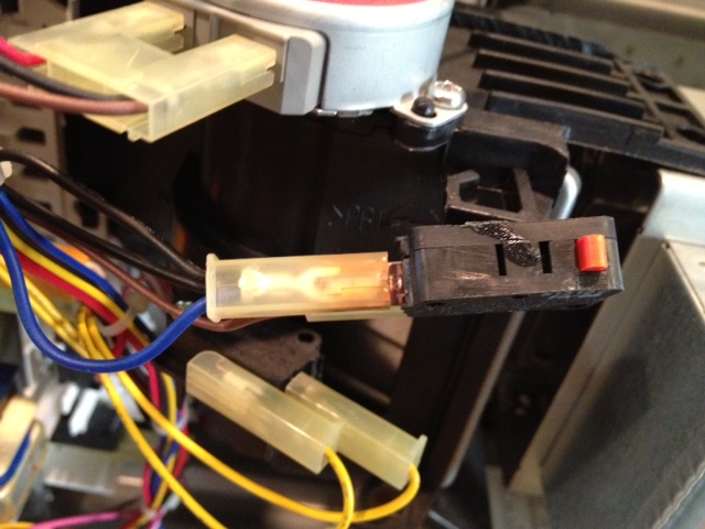

Thanks a lot. Removed the control panel #923 (FYI, it has one screw at the bottom as well). I have installed the new latch board, micro switch etc.

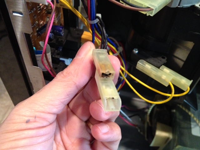

Just one quick question, one of the connector to the top micro switch (the one that got busted second time) shows burning signs. Although it still hold well to the micro switch connectors. Do I need to replace this?
See the attached pics.
Thanks a lot.
[FONT=&quot][/FONT]
Hi.
I highly recommend you to replace this conector.That could be the reason why the switch goes bad.
Simon.
Hi Simon / APP Team
Thanks for the response. Agree with your recommendation.
I removed the damaged insulated 2-wire female connector, however I am not able to find the similar 2-Wire Insulated connector here. What’s the part number for these so I can order these with APP.
Also will appreciate some instruction on installation of this 2 Wire female connector.
Hi.
You don’t need to replace the entire connector. Use the side cutters to cut off the bad one and replace it with regular crimp on connector.
Simon.
Hi Simon
Sorry couldn’t get back earlier. Thanks for your below response.
I see the regular crimp on connectors don’t fit well.
I think I may end up replacing the entire connector bunch. What’s the part nbr for that to order.
Hi.
I don’t think they are sold as a separate parts from the manufacture. I have used the regular connectors many times without any problems in the past.
