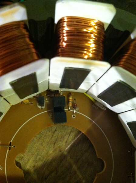

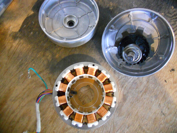

I’ve had the same intermittent blower problem for months now. Just replaced the transistor mentioned in this thread (mouser PN: KSA733CYTA), and so far it appears to be working. Thought I would post a couple of pictures of the blower motor disassembled for anyone else thinking about making this repair.

Hello this is my first time posting here as I had encountered the same problem with mixed results, finally ascertaining this was a mechanical issue pertaining to motor armature/encoder flag wheel out of position in relation to the motor rpm sensor hose shoe through normal wear of the forward bearing wave washer and motor housing alignment. The housing screws need to be tightened firmly as possible ensuring proper flag sensor alignment and also replace or reform wave washer (the main culprit) ensuring positive armature down force towards rear of motor housing ensuring proper encoder flag photo transistor sensor position. when reinstalling motor be sure motor mounts in frame completely seated clip should go on relatively easy reassemble dryer and have cold one like I did not spending any money on this ensures a wife friendly beer purchase and clean DRY clothes enjoy this simple repair. I also tried the transistor only to realize thruogh voltages checks and electrical component tests that the encoder circuit was indeed functioning properly leading me to this simple wear and tear easy fix, let me know if this solution helps any of you. The armature wave washer belongs in the front bearing race. (front of dryer facing)

most likely just a worn wave washer in the blower motor front sealed bearing race, purchase 2 new washers as they easily fit and ensure armature flag encoder alignment. also motor housing screws loosen on there own over time causing misalignment. sometimes cleaning and tigtening housing screws will get you back up and running if your not confident about splitting the case to get at worn wave washer for replacement. Hope this helps your husband out. netnick
Netnick, Thanks for the reply. I have to disagree. All the encoder flag has to break the beam between the transmitter and receiver. Installing or reforming a new wave washer only slightly moves the flag back toward the rear of the motor. The flag still breaks the beam between transmitter and receiver, the flag is just moved slightly. The circuit may have an intermittent electrical problem, but I don’t think it is a mechanical alignment issue. thanks.
If your wave washer is worn than this is only an intermittant fix, it must be replaced every time the motor starts the wave washer is compressed due to the torque at initial start up the squirrel cage / shaft of the motor springs forward momentarily causing armature flag to just slightly miss breaking the beam and with a worn wave washer it does not have enough spring action left to counter act initial motor start torque the tolerances in the design of the encoder err on the side not causing flag encoder damage thus over time decrease in the counter acting ability of the wave washer to keep the motor shaft encoder flag in the encoder horse shoe within the tolerance of consistent operation.-while in factory test mode while reading blower motor rpm manually turn blower wheel to see if its reading rpm this can be done at anytime before or after starting the test if you only read 0rpm then push and turn blower wheel towards back of motor there will be small amount of play this by design to buffer motor start-up if you see rpms than encoder circuit is fine. Than you need to deal with excessive motor shaft play. IE: wave washer replacement. thank you and I hope this clarifies where I was going with the post “good luck”
