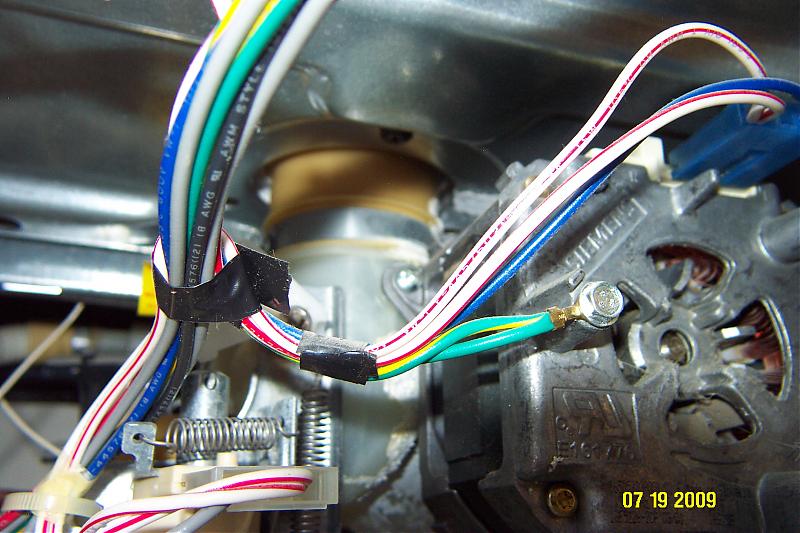

My dishwasher leaks. The best I can tell from looking, I need to start by replacing part WD18X214, the yellowish piece in the top center of the attached picture.
But I’d like a sense of how to remove it and what else needs to be removed to get to it. The complication I expect is that the plumber who did the hook up did not leave enough tubing which runs from the dw cabinet into the adjoining cabinet and attaches to the garbage disposal. Without disconnecting that tube and feeding it back through, I can’t pull out the dishwasher more than about 10 inches. I expect this part can’t be removed without pulling out the dw and laying it on its back.
Any thoughts appreciated.

[FONT=Arial","sans-serif][COLOR=#000000]Part # WD18X214 pump connector is a commonly failing part that is used in many models of dishwashers by GE, Maytag, Kenmore, and others. Depending on your dishwasher and the amount of space in your installation, you may find it just barely possible to replace this part without removing the dishwasher. Otherwise, you may have to remove the dishwasher. For my dishwasher (GE model# GSD4930Z00WW) I felt that it was easier to replace the part without removing the dishwasher. (That is to say, I traded the hassle of removing the dishwasher for the hassle of laying on the ground and working in close quarters.) Following are instructions that I made for myself based on the last time that I replaced the WD18X214. I am in no way encouraging anyone else to follow this procedure and I accept no liability for any damage or injury incurred by anyone who utilizes this procedure.[/COLOR][/FONT]

  • [COLOR=#000000][FONT=Arial","sans-serif]Using a 5/16” socket (preferably on a screwdriver handle) loosen the bolt on the hose clamp that holds WD18X214 to the pump housing. (Upper middle of attached photo.) It’s probably best to completely remove the clamp, and completely remove the hose clamp, but if you do so, be careful not to lose the nut on the back of the hose clamp since it is not permanently attached.[/FONT][/COLOR]
  • [COLOR=#000000][FONT=Arial","sans-serif]Using a 5/16” socket, remove the bolt from the lower right of the pump motor that is connected to the arm holding the pump up to the frame. (Lower right of attached photo.) This will let the pump housing drop down enough to finagle in the old WD18X214 hose out and the new one in.[/FONT][/COLOR]
