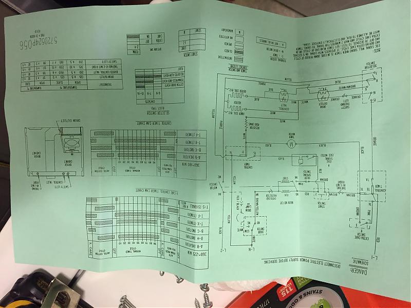

I have also attached a photo of the wiring diagram incase it helps any.
dryer diagram.jpg (72.5 KB)
Since you have heating at times we can rule out all safeties/thermos and the elements. None of them would be likely to have an intermittent issue other than a loose or burnt connector.
So that leaves the timer as the most likely issue. I’d definitely like to examine the prongs of the plug for evidence of arcing, same with the cord connections at the terminal block, either of which could cause intermittent issues. If no burns or pitting on those parts I’d say its internal to the timer. I may be wrong as diagnosis online is not easy on odd issues but you’ve got to start somewhere.

There is a centrifugal switch on the motor that provides L2 120v to the elements. On that pic above trace L2 to the motor switch. That’s it.
When the motor spins up a pair of spring loaded weights on the inner shaft spread out and push an arm to close the circuit. If one of those springs is off or broken that would cause it. You can slide the plastic color attached to the the weights to simulate spinning but moving the switch arm is easier. The arm itself hangs out of the back of the terminal block on most motors I’ve seen. You can manually move it and see if that circuit closes, creating continuity or very low resistance through the switch. It looks like it’ll be black to purple on the motor terminal block. That brown plastic on the motor is pretty fragile so be gentle on it.

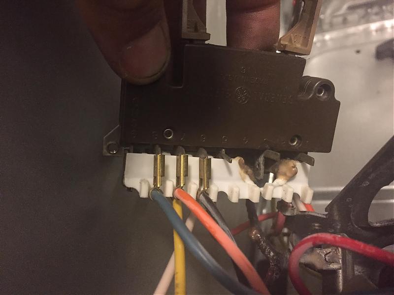

Well looks like I found the problem. The L2 wire caused some chaos on the motor switch. It looks like the terminal was loose and may of starting arcing creating quite a bit of heat. Maybe it had rattled off of its post and rested against the post for my intermittent heat, and that’s when it really heated the switch up.
I repaired the wire and put a new end and connected to the motor switch hoping it would work but no such luck, so i’m guessing something has melted within the switch. The brown parts of the switch do move with the clutch but I get no continuity anywhere so i guess I just need to get a new motor switch?
Ive looked at some breakdowns but cant seem to get detailed enough for a part number, do you have any idea of the part number.
I attached some pictures of the carnage.
Well I’d say you found the problem.
We usually replace whole motor so I’ve never tried to find just the switch.
You might try using manufacturer data on the motor to look for parts or see if there’s a local elec motor repair shop near you and get lucky, I doubt GE made it as the same brown switch is on most motors I’ve seen.
You’d need to cut that overheated and corroded wiring back to a good spot and crimp new terminals on or you’ll be doing it again soon.

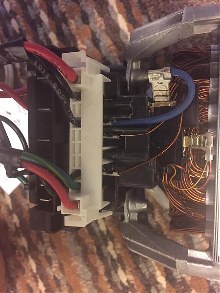

So I got the new motor in but the motor switch is different so I dont want to hook it up the wrong way. The instructions didnt give any details on the posts on the switch. It only said that the ground had to be moved to the shell.
Atleast the old switch had numbers on it, this one does not!
I have attached pictures of the new switch and the old switch pattern.

The motor is pretty simple. It only has two windings, start and run. Start ohms out higher usually. You know which wires run through the centrifugal switch so you can ID them. On the motor side the blue wire is probably the start winding as it runs through the thermal safety.
If I came across this on a service call I probably leave the wires in the terminal block of the motor where they were as long as they were connecting with plugs that had wires on the harness. And I would try it.
GE makes theirs a little harder to run open because of the belt switch but you can try it all live by just rotating the front panel away and leaving the door switch attached. I don’t like to work on them live unless I have to but in this case I’d say try it and if it doesn’t run normally or trips the breaker then worry about it.
You can try to use the wiring diagram to ensure that wires are going to the appropriate windings. GE makes a pretty light wiring diagram. There’s just not much detail.
the new switch does have numbers if I remove the jumps, the numbers dont match up. and I hooked it up. Blown breaker
Well then. You’ve got a puzzle.
Start with the motor. Ignore the wire harness for now. I wish I had a better answer as you’ve invested a lot of time and $. Here’s how I’d start. I’ve never had to go this deep on a motor, odd as they usually drop right in. But here we are.
ID what motor terminals are the centrifugal switch. That’ll eliminate 2 wires. It’ll obviously be the pair that closes when you move that arm.
This is how I do it on compressor motors if i have doubt and i think it’ll be the same. To ID motor windings ohm out the remaining 3 that go into the motor itself. You’ll get 3 readings: the highest is across the 2 windings, roughly the sum of the other 2.
So say you get 3, 6, and 9 ohms. 3 and 6 are your windings, 9 is across them. So when you see the highest reading the odd pin out should be your neutral, it may be the one that goes into the thermal safety.
I’ll see if that test actually works on a dryer motor Wednesday if I have one to test. It should. I think I have a Samsung motor with a bad switch waiting for recycling.
From there you can use the schematic to see which harness wires go where. The comp!ex part is that the harness plug is used as a junction as well, which may be marked elsewhere on the paper schematic and the wire colors may change. Its just how vague the schematic is.
