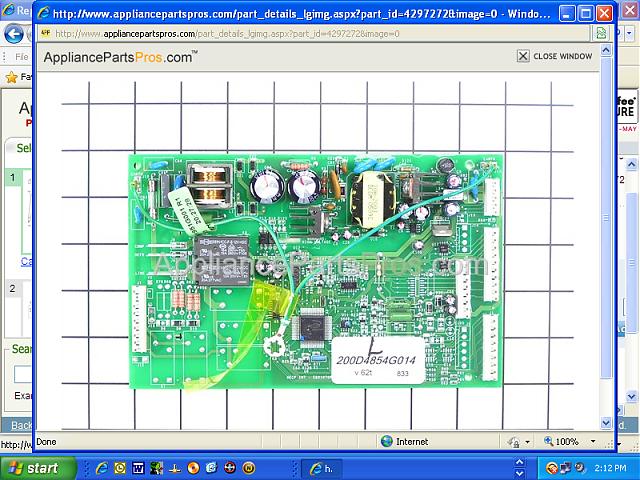

Ge motherboard part # mix up?
[FONT=Arial][SIZE=3][COLOR=#000000]Ge motherboard part # mix up? [/COLOR][/SIZE][/FONT]
[FONT=Arial][SIZE=3][COLOR=#000000]Ge pds22mfsaww bottom freezer [/COLOR][/SIZE][/FONT]
[COLOR=#000000][FONT=Arial][SIZE=3]Order Date: 05/12/09[/SIZE][/FONT][/COLOR]
[SIZE=3][FONT=Arial][COLOR=#000000]Order Number: 673294[/COLOR][/FONT][/SIZE]
[FONT=Arial][SIZE=3][COLOR=#000000]part #AP4297272 (WR55X10656) Main control board assembly domesti [/COLOR][/SIZE][/FONT]
[COLOR=#000000][FONT=Arial][SIZE=3]this one looks exactly like mine on your site[/SIZE][/FONT][/COLOR]
[FONT=Arial][SIZE=3][COLOR=#000000]Board #200d485[/COLOR][COLOR=red]4[/COLOR][COLOR=#000000]g014 this is the one I ordered # diff 4[/COLOR][/SIZE][/FONT]
[SIZE=3][FONT=Arial][SIZE=3][COLOR=#000000]The one shipped #computime 200d485[/COLOR][COLOR=red]0[/COLOR][COLOR=#000000]g014 [/COLOR][/SIZE][/FONT][COLOR=#000000][FONT=Arial]# diff 0[/FONT][/COLOR][/SIZE]
[FONT=Arial][COLOR=#000000][SIZE=3]The part # is the same but they have different # on the board and are very different [/SIZE][/COLOR][/FONT]
[FONT=Arial][COLOR=#000000][FONT=Arial Black][FONT=Arial][SIZE=3]I will attach the pictures if I can[/SIZE][/FONT] thanks rock[/FONT][/COLOR][/FONT]
[FONT=Arial][SIZE=3][COLOR=#000000][ATTACH]1044[/ATTACH][/COLOR][/SIZE][/FONT]
[SIZE=3][FONT=Arial][COLOR=#000000][ATTACH]1045[/ATTACH][/COLOR][/FONT][/SIZE]

My situation is just the opposite. The board I removed from my refer is like the lower photo and it has 5 plugs on the right side. The board I was sent is similar to the upper photo with only 4 plugs on the right. The box was labeled W55x10942 but the board doesn’t look like any of the photos of similar boards on the web. There is no J-5 and a lot of components are not there, just a bunch of jumers. Also, the board I received has one less relay. A schematic I have says J-5 is for the Quick Chill (somethng-can’t read it). My refer is a PSI23SGNA. Was my box mismarked or wrong bord inside? Numbers on the board are: EBX1110P003; 94V-OOPCVO; 702130401.01GA and SWS 1048 (rev 1).
A sticker on the board has the following codes: WKKT 1304-00-00; 200D6221G009 and R102FC 3706DG. Anyone got a clue?
My old motherboard (MB) number is WKKT 1304-00-00 & the one I received is WR55X10942. Is the new MB the correct replacement for the old one?
Whenever I check to see if another MB should be used, the new one is the one that shows up.
If so, how do I connect to the new MB since it has more connectors than the old one?
Flynn
All parts sites deliver the WR55X10942, a redesigned board that’s probably more reliable.
It is pretty hard to miss-wire the new board, just plug in all the connectors into the new board where they where on the old board and ignore the other sockets on the new board.
