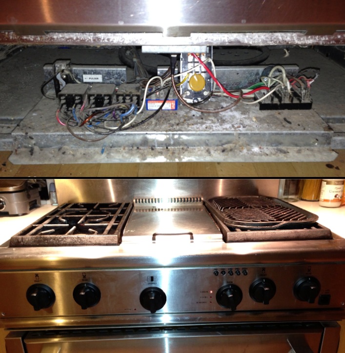

I have a Monogram 36" Range, ZDP36N4D#### (with Griddle and Nat Gas, electric oven). I’m not sure of the exact model number.
The broiler doesn’t work. Nor does self cleaning (which I hope is whatever is making the broiler not work.)
I took things apart, the broiler heating element looks fine, there is continuity when connected from plug to plug, and there are no breaks/continuity from outside to inside, and there was resistance.
Not sure if this means anything, but my wife has said for years that the oven is always like 25 degrees too hot. (And the broiler has probably been broke for many years, we don’t try to use it hardly ever.) But I’d like to clean!
Here is a picture of the electrical parts underneath, and the knobs up top for reference.
Can anyone help me determine what part might be the culprit?
Thanks in Advance!

There are two indicator lights which should be lit when you turn the Broil on: the On light and the Heat light. Do they go on when you turn the Broil on?

Neither light comes on, but the convection fan (or some fan) starts up.

I re-attached my picture to my original post, because I think maybe people can’t see it from where it was originally hosted. Maybe this helps?
I looked at another site and saw that the electrical diagram from ZDP36N4DH1SS, ZDP36N4DH4SS, ZDP36N4DH5SS all look like mine, except none show this extra relay/part in the middle (the one the the bright red wire from the right is connecting to in my picture).

The relay in the middle on your picture is hot wire relay. You may want to check it for continuity between the terminals S & R. If there is no continuity, the relay has to be replaced.

I do have continuity - and the part looks good. I guess I could buy it and return if it doesn’t fix the problem. Anything else I should check? - Thanks in advance.

  1. In screwing with the inside of the hot wire relay then replacing, I shorted and destroyed the hot wire relay. This caused a spark inside the relay. Therefore I replaced the —
Hot wire relay AP2023720
  1. Then nothing worked (exactly as described above) – I’m assuming the resulting shorting caused more damage. Then I decided that perhaps because the temperature had been described as wrong before, the next thing was to replace the —
High temp cut out / thermometer AP2023717
But after replacing that, I’m still exactly where I stand as described.
  1. I’ve looked at the various parts in the electrical area and cleaned up the dust. Everything looks good at a glance.
That takes me to today and the state of the oven function.
What should I try next? Another post I saw was starting to talk about the buttons, but the bake, conv, and broil buttons all appear to do at least something. I have not removed to panel to see what else happens at the oven back there.

You may want to verify that the red button in the center of the high temperature limiter you replaced is pushed in. Then make sure the blower comes on when the selector button pressed and check the air switch (#550 at the diagram).

My bake element works intermentitly…the broil element works, the convection fan works, the broil fan works. the problem is that the bake element will not come on for awhile, but then it will come on and glow red, so I assume the bake element is ok…could this be a bad hot wire relay part number WB21X5362
Or maybe an oven temp sensor?
I have made sure the high temp cut out button is pushed in.
any help would be great.
I also switched the relays between the bake and broil, but no luck.

Yes. Mine turned out to be the hot wire relay like what’s in the picture in the other posts. Works perfect since the repair
