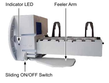

GE Model GNE27JYMWFFS bottom ice maker quit again
Brand: GE
Model Number: GNE27JYMWFFS
Main Symptom: Ice maker quit
Parts or tests already tried: water filter
Frig is 3.5 years old. this has happened about 4 times, but a filter usually fixes it. Not this time.
Cycled switch several times. Even put in GE filter plug to try by-passing the filter. Yes, I did order one just in case.
I’ve attached the icemaker diagnostics below. Try cycling the icemaker. If it cycles but doesn’t fill you may have a valve or filter head issue. Let me know what it does when you try cycling the icemaker.
