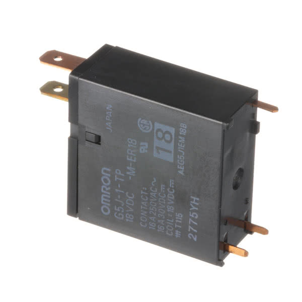

Can I replace the relay or do I have to replace the entire control board? If the relay is replaceable what info do I need from the relay body? There is a lot of info printed on it. Thank You.
Have you taken the board out and checked for burnt traces or bad soldier connections? Are you sure the relay is bad?
Yes, if its just the relay you can replace it. You need to be proficient at soldering.
This is just a random picture of a relay from the internet. If you look at it, Omron is the manufacturer. G5J-1-TP-M-ER18 is the part number. It’s an 18 volt relay.
Do a search for [SIZE=3]your[/SIZE] part number. Check Google, Epay, Digikey, Mouser, etc.
The microwave is working now. I was guessing it was the relay as the manufacturer’s trouble shooting flow chart said to check it’s voltage. Would testing reset it? If the relay requires soldering then I’m out of luck…I don’t own soldering equipment and have never soldered. If the microwave fails again I’ll just buy a new one or replace the failed part. It’s an over-the-stove model so a little more expensive than a counter top model.
If the board was out and I had the part , I could replace it in less than 10 minutes. Its really pretty simple. Maybe you could take it to a friend and they could solder it for you.
The relay probably has burnt contacts and the carbon was keeping it from completing the circuit. Bouncing around probably cleared off enough to get it going for awhile.
