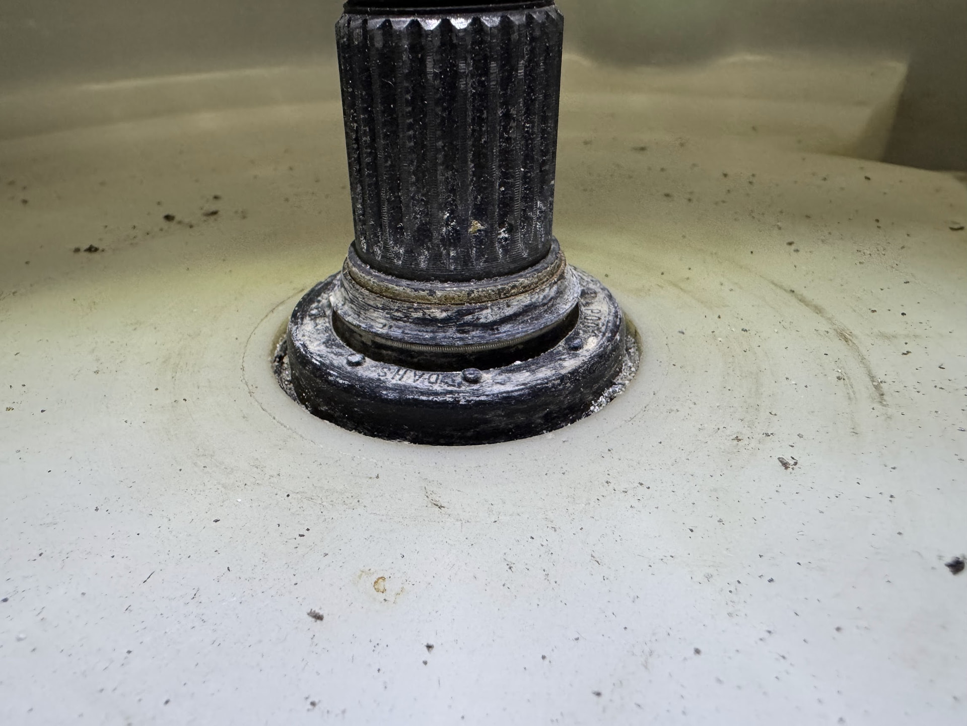

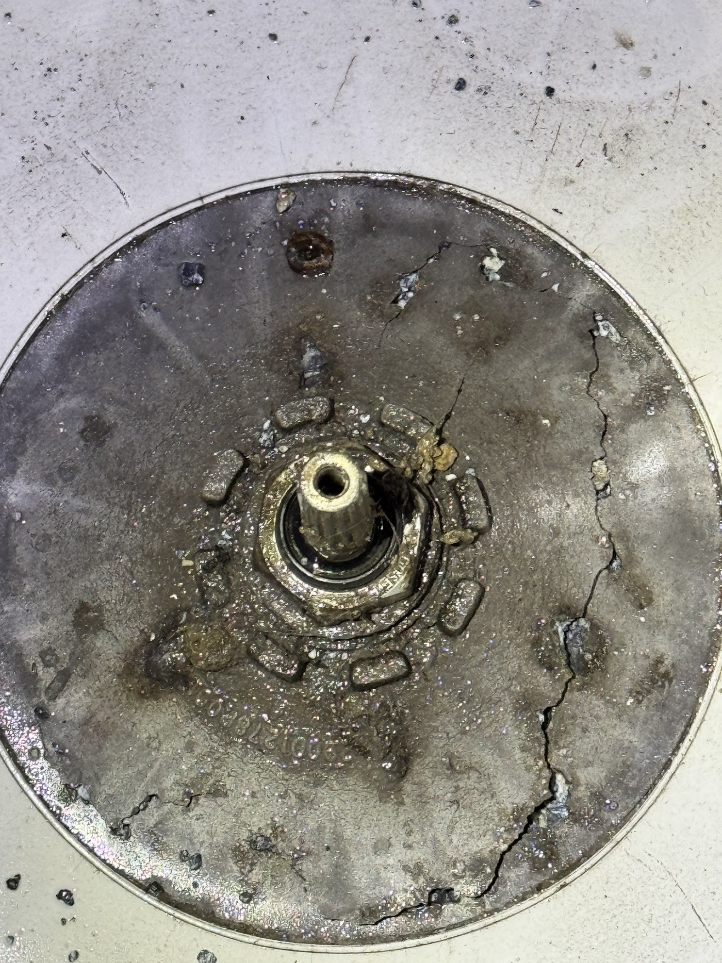

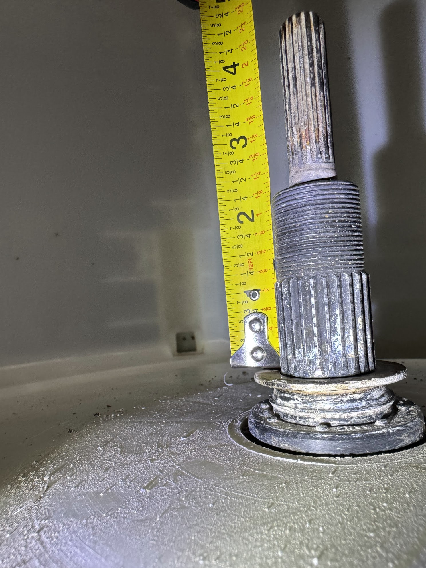

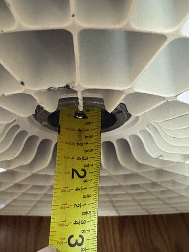

My GE washer stopped working. Took a look and the basket is corroded, as is apparently typical on these units. Ordered a new basket, but the new unit’s hub is very different than the previous unit’s. The original unit’s hub was completely splined, the new unit’s splines don’t start for an inch or so. It is also a lot thicker, maybe 3/4” or so. The splines on the transmission shaft are only an 1” long, so there is physically no way this can work, as far as I can tell.

Spline depth:
Distance TO the splines on new drum (over 1”):

It doesn’t look like the gearcase has been redesigned, and the manufacturer doesn’t have any notes on this that I’ve been able to find. From the pictures of the new basket, I’m wondering if you may have been sent the wrong one, that hub doesn’t quite look the same as the manufacturer’s pictures or any others that I’ve been able to find. It might just be the lighting in your pics, but in all the ones I’ve seen, that hub is a much darker gray and is not the same shade as the rest of the bottom of the outer part of the basket.
I agree, I think I was sent the wrong part. A friend of a friend, that happens to run an appliance repair business, took a look at a Facebook post I made and said that I had the right part number but the part wasn’t correct – in fact he had just installed the same and his looked very different.
I have an open request to the part supplier, hopefully they agree with all of us and replace the part.
Following up on this – I purchased another drum, same part number and ultimately from the same GE parts warehouse, and it was a very different part that fit perfectly. So, it does seem the wrong part was boxed up and sent out the first time. Still waiting on GE to agree and refund my money on that first purchase.
