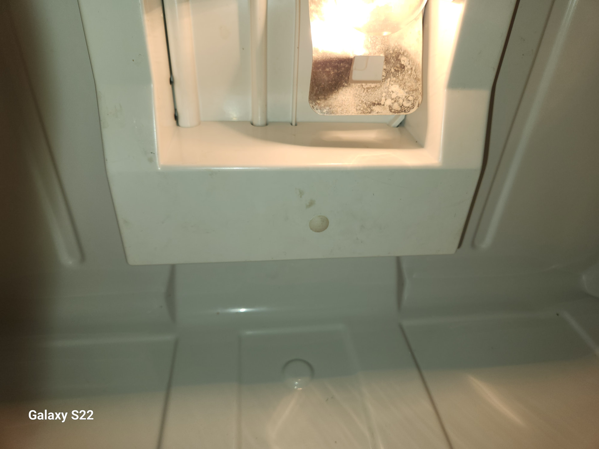

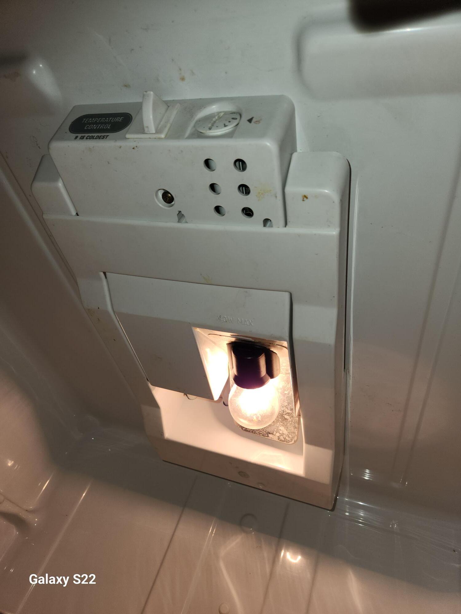

GE GTH16BBSXRWW cannot remove temp regulator from the rear
Brand: GE
Model Number: GTH16BBSXRWW
Main Symptom: Cannot remove temp regulator
What happens & when: Received the thermostat WR09X20002 but I cannot remove the temp regulator from the rear to install it…the video does not help

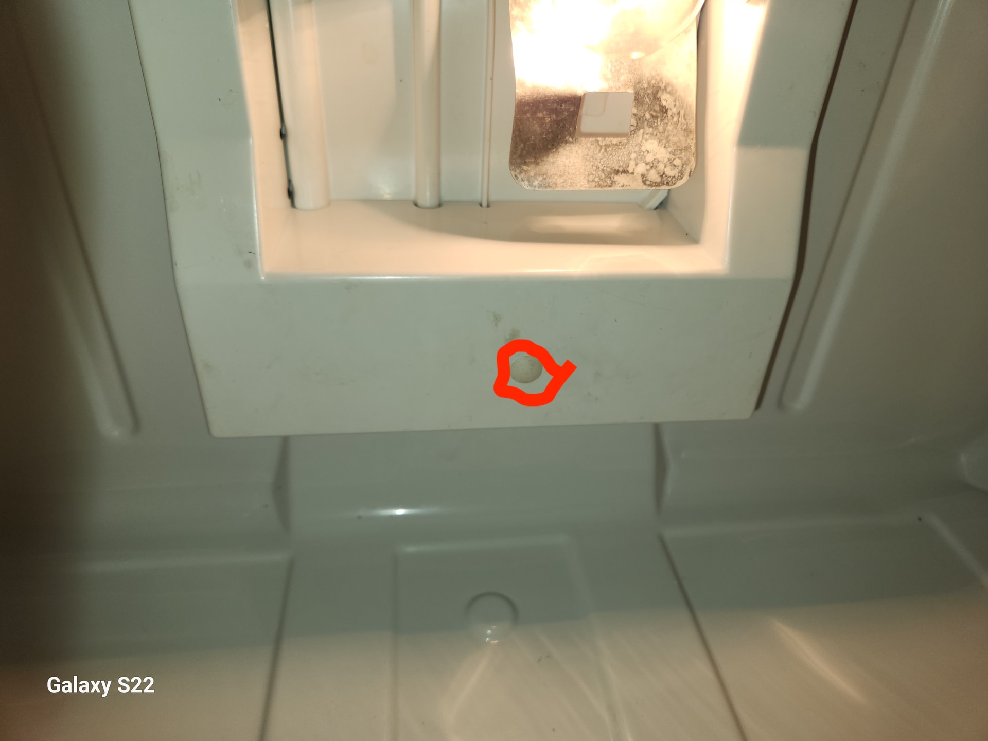

There is a second retainer on this this thing that is apparently hiding the rear screw…and it is inviting me to damage the whole unit.
That looks like if you use a putty knife it would come right out.Here is what I think you’re talking about about in the back? https://www.partselect.com/PS283598-GE-WR01X10149-CLIP-CANOE.htm?SourceCode=1&SearchTerm=CTZ16EACDRWW&ModelNum=CTZ16EACDRWW
