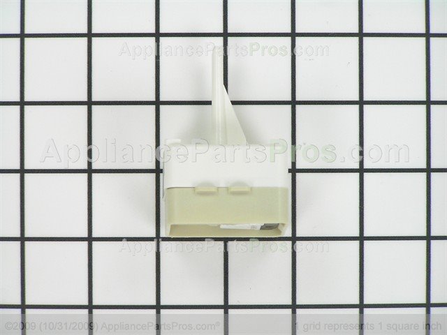

What happens & when: Clicks then hums for about 5 seconds about every 2 minutes
Error Code (if any): no error codes
Parts or tests already tried: Not able to test without a multimeter, but un-installed start relay and noticed a rattle with light shaking. I’m thinking it that part, but the new part looks similar, but the connector posts are in a different location. I want to make sure that I connect the wire correctly. Black wire to the correct post and the white wire to the correct one.
The start relay part is WR07010131.
