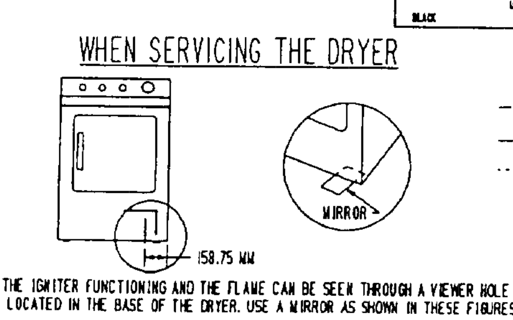

GE Gas Dryer DNCD450GG1WC - shuts off after 2 - 3 minutes
Brand: Ge
Model Number: DNCD450GG1WC
Main Symptom: runs for 2 to 3 minutes then stops
What happens & when: the heat/flame seems to come on fine but will stop within 2 to 3 minutes.
I spoke with a Repair mechanic and tried to troubleshoot a little bit. I took off the vent in the back to make sure it wasn’t a airflow restriction. That that’s not the issue.
mechanic and tried to troubleshoot a little bit. I took off the vent in the back to make sure it wasn’t a airflow restriction. That’s not the issue.
Also I checked the ohms on the moisture sensor and used a wet paper towel to make a connection between the two sensors, and there are no om readings, but the repair technician said that has never been an issue. Those don’t go bad.He mentioned that it might be the coil that has gone bad. The schematic show a main coil and a secondary coil. Also, per your forum it could be a cycling thermostat, but There are 2 Cycling thermostats. If you think that is the issue, which one might it be.
230 on blower & # 505 on drum schematic
Main coil 731
he mentioned that it might be the coil that has gone bad. The schematic show a main coil and a dual coil. If you think it might be the coil, which one might it be?
ThankIf you think it might be the coil, which one might it be?
Thank you so much for all of your help.
Evan.
Also, there are two different cycling thermostats.Error Code (if any):
Parts or tests already tr
The thermostats can be checked for continuity and the coils can be checked for resistance.

I would be looking at like in this screen shot the with the mirror the sounds of a click and the viewing of the glow coil and then no ignition of the gas and this would go on and on with almost certain a indication of the black coils that is always replaced as a pair!
