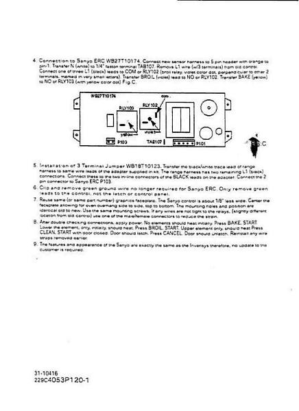

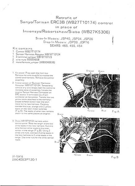

The parts recommended to be replaced arrived today. Of course it is not an exact match to the original part. I followed the instructions step by step but now the only thing working is the oven light. Attached a couple of pics of the new part. ERC does not even light up. Which would indicate to me that no power is getting to the EC unit. Oven has power as the light works. Instructions state that the ground wire (green) does not get hooked up to the new ERC (and no place for it to do so anyway). Any direction would be greatly appreciated, getting tired of eating out and worse my wife is having way too much fun at my expense at this point.

As far as I remember there suppose to be “L” or “L1” terminal on the new ERC and the black wire should be connected there as well.
Can you post the instructions came with the ERC?
Two pages of instructions attached. Stove top burners do have power.

Bob,
Thank you for the instructions but I can not read them - fonts are too small and it is not possible to enlarge it without loosing quality. It might be better if you’ll attach the file to the reply instead of post it in the reply body.

Trying the instructions again as an attachment this time.
Don’t know why but regardless of how I try to attach the files it imbeds them. I was able to use windows picture manager to enlarge them. they did fade a bit but were still legible.
