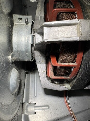

**Model Number:**GTD45EASJ2WS Main Symptom:Belt keeps breaking What happens & when:
Dryer stopped spinning. Replaced belt.
Dryer stopped spinning. replaced belt. Worked ok for 2 weeks, but got louder each day
Dryer stopped spinning again. replaced belt and slides. Worked ok for 3 week, but is now louder, and sounds like it will break again. Takes longer to dry as well.
I see the videos for idler wheel, and motor pulley(have to buy the whole motor for this model?) but am looking to see if it may be something else.
Is the drum somehow moving from center, either in the front bearing, or off the shaft in the back, putting strain on the belt?
The noise is an out-of-round sound louder at half spin. Not a squeel but a rubbing sound.
Would like to but the right part(s) this time.
Montel
What bigbuck1 is referring to will be at the motor itself. The motor being positioned incorrectly might cause some problems getting the belt on as well. If you take the belt off the pulley is the drum still hard to rotate by hand?
thanks-will have to disassemble and report back in a few days. I do remember pushing hard on the drum to get it set in, so maybe it caused the no-gap scenario.
