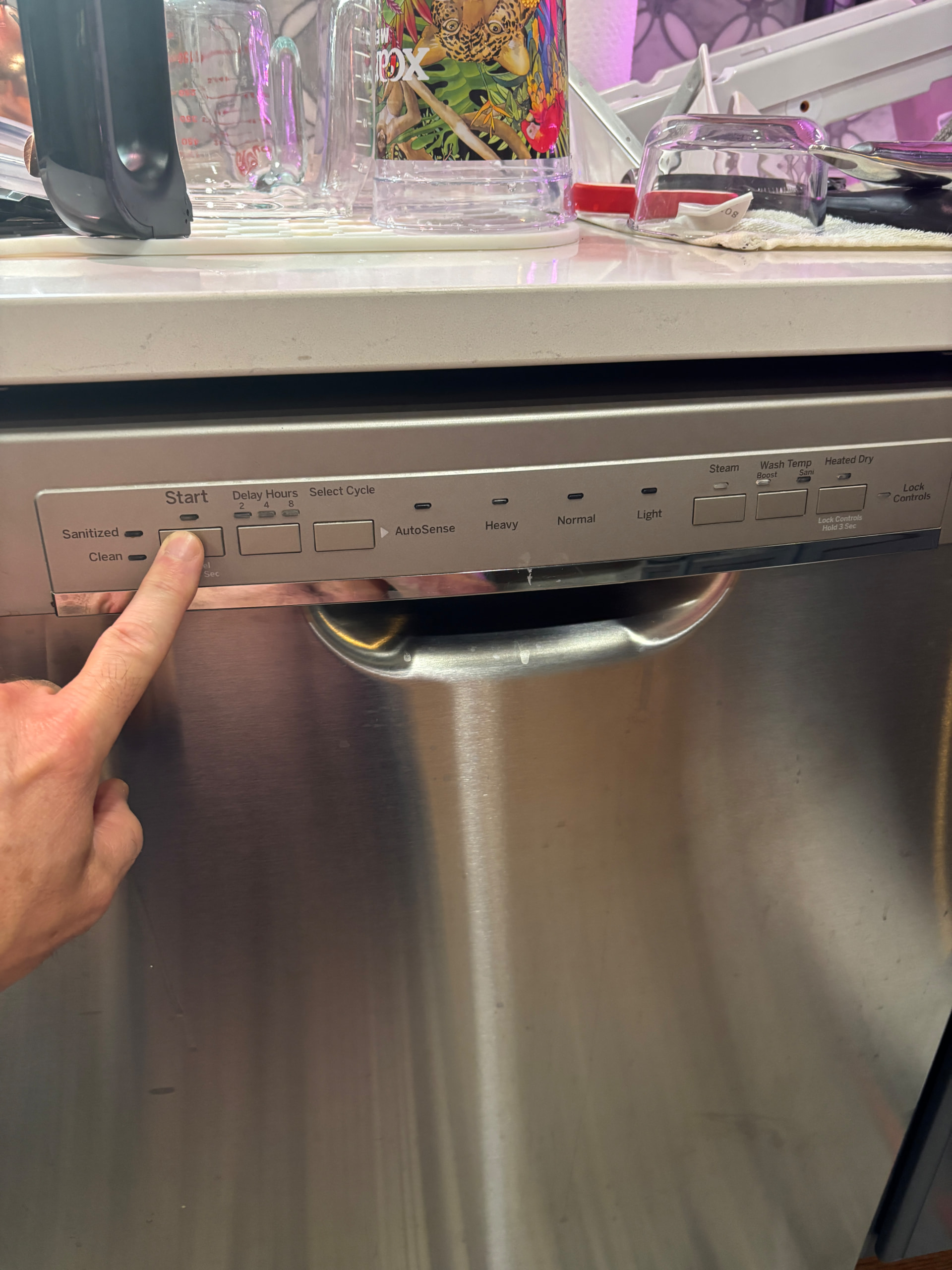

The random beeping before failure is often associated with:
  • Moisture intrusion into the console
  • Failing UI board/keypad
  • Communication loss between UI and main board
Even with a good main board, a failed UI can make the dishwasher appear dead.

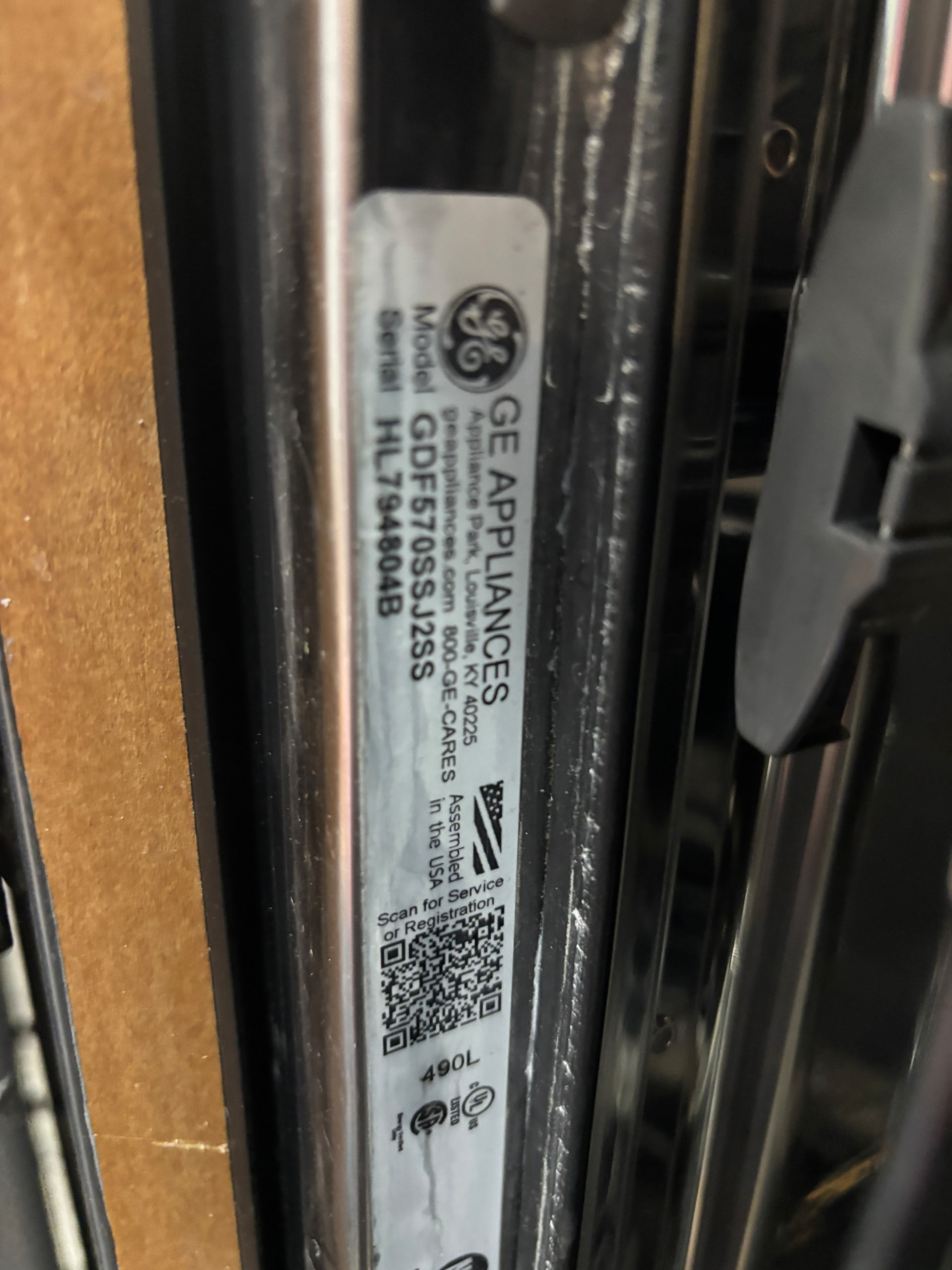

  1. Can you confirm the model is GDT570SSF2SS (or provide a photo of the model tag)?

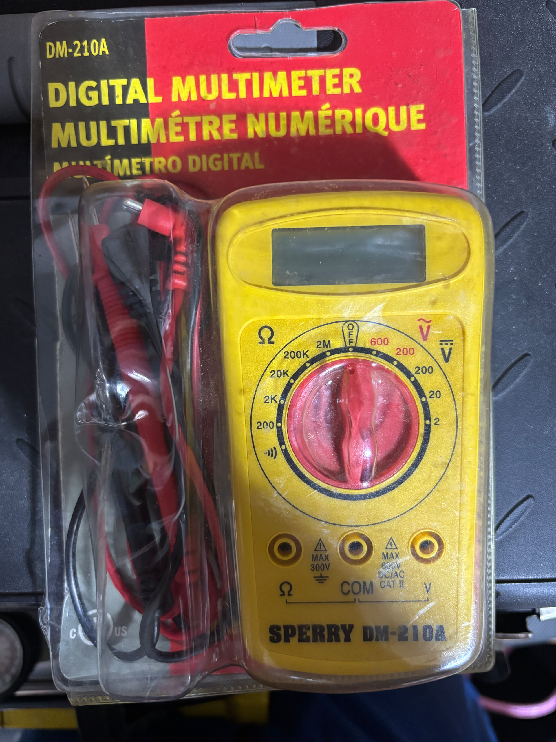

  2. Do you have a multimeter?

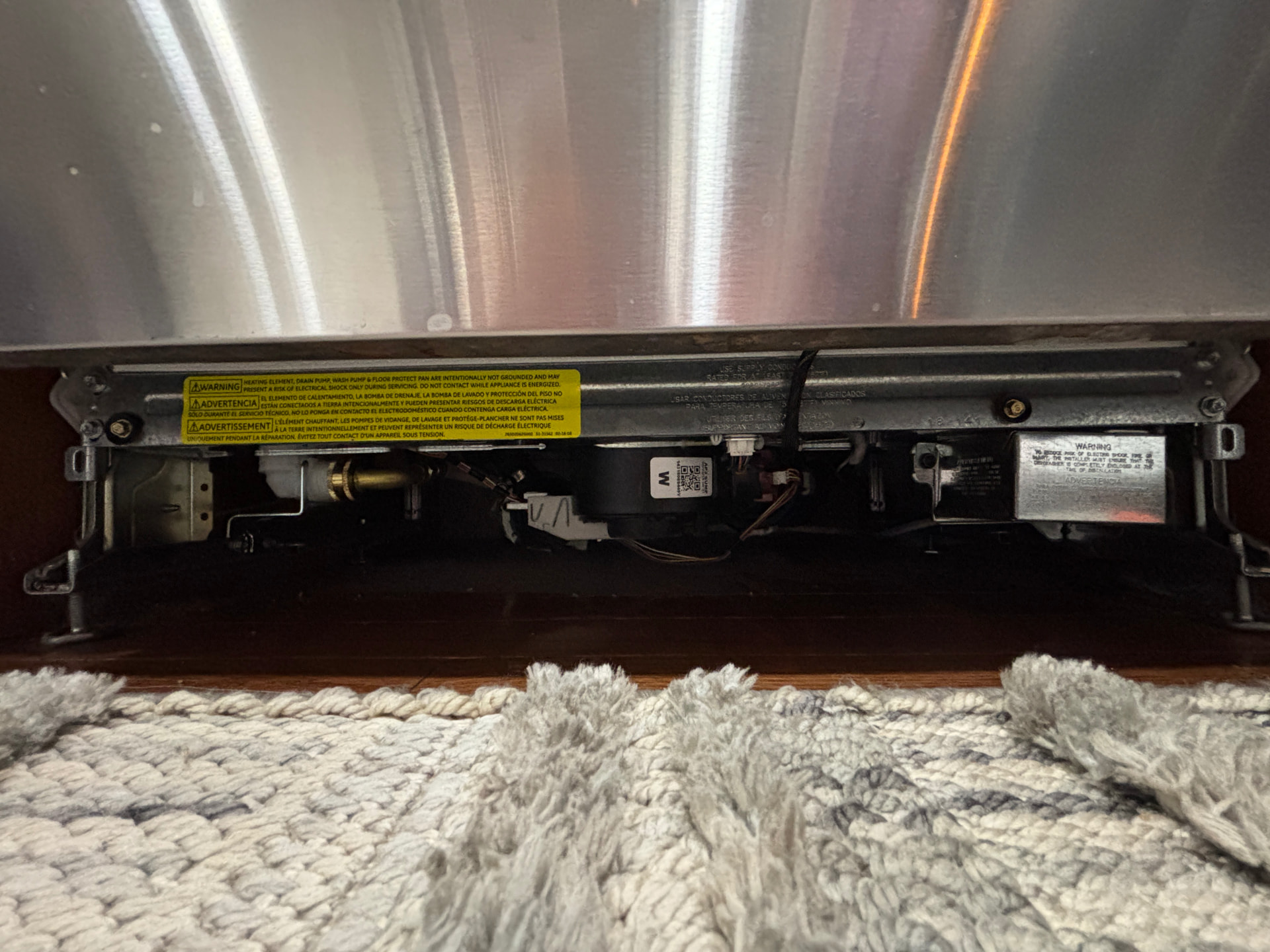

Here are some photos, I read somewhere about the LED on the main control board but not sure where I’m supposed to see those.
And yes I have this multi meter, but honestly not sure how to set it to check for the readings you mentioned
I have enclosed the mini service manual for reference. If you are unfamiliar or uncomfortable with check for voltage at the dishwasher and board. I would advise against doing it. There are self diagnostics on the service sheet you can try first

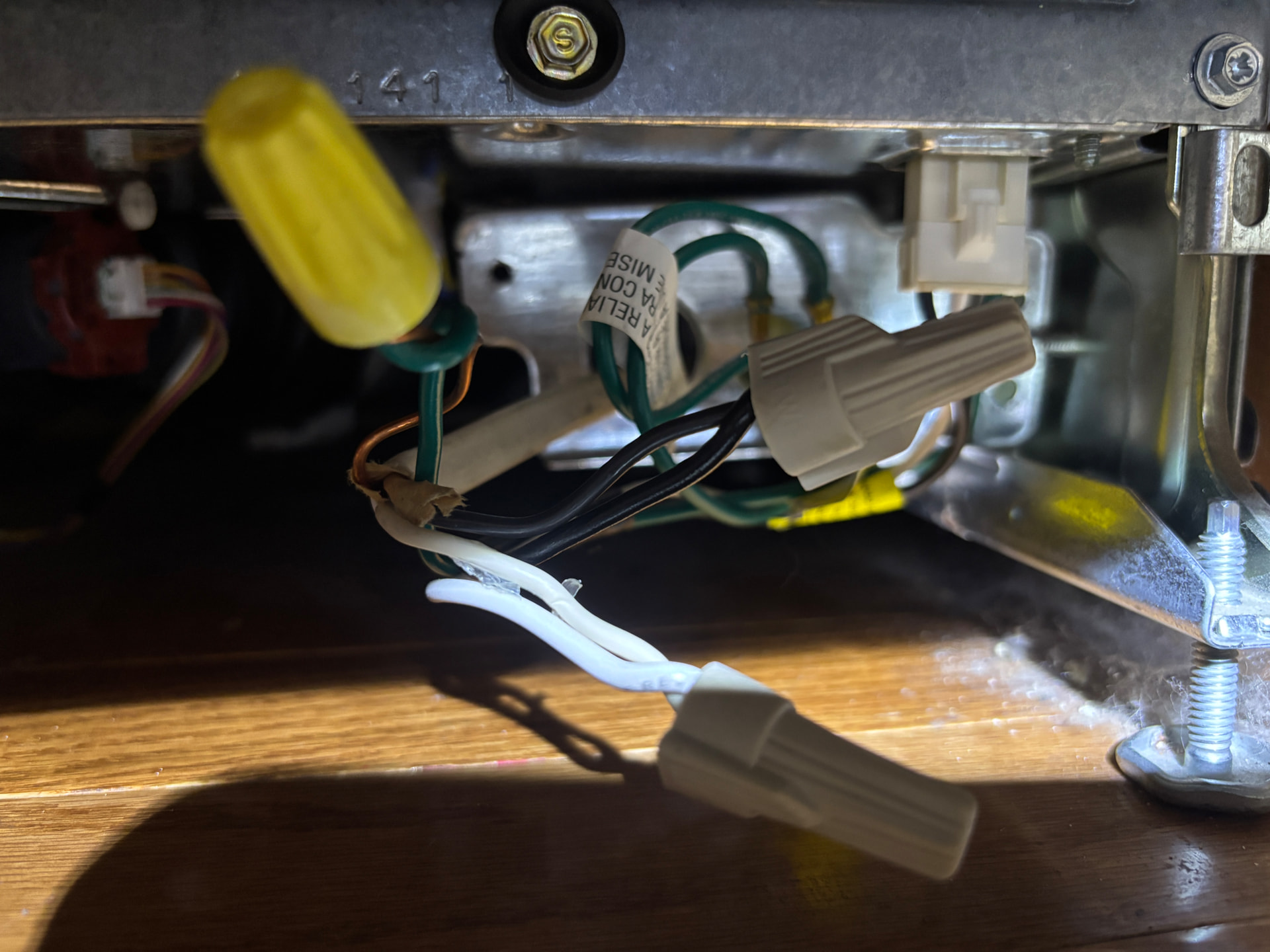

Opened the junction box, tested the wiring as instructed and wasn’t getting anything on the multi-meter. Turned the power off, removed the wire nuts, but left everything connected as it was. Turned the breaker back on and we had power, checked the wires with the multi-meter and they all checked out. So I went and re-did all the wires, stripped back the copper and put the wire nuts back on. We’re running a wash now, and seems to be working! Is there anything else I should check?
Ran a full wash cycle with no issues, then this morning the dishwasher just randomly beeped again and the lights came on?
No it seems you may have found your issue. Sometimes just from age and cycling the connections in those wire nuts can get week. Just make sure they are on as tight as possible
Still getting random beeps after checking all the connections in the junction box. Last night unit died once again, no lights no power.

  1. Check the junction box again
    • Black → White = ~120 VAC
    • Black → Ground = ~120 VAC
    • White → Ground = ~0 VAC
If Black→Ground is 120 V but Black→White is missing or unstable, I would strongly suspect an intermittent neutral connection.

One important model-number issue
Please double-check the model tag.
You gave GDF570SSF2SS. GE’s parts information for that model shows the original machine control WD21X10531, superseded by WD21X22276.
The WD21X24901C board you installed is listed for models such as GDF570SSJ2SS.
So if your model is actually GDF570SSJ2SS, WD21X24901C makes sense. If the tag really says GDF570SSF2SS, we need to address that before condemning anything else.

I’m not getting any lights or power to the UI at this point, checked all the connections and managed to move the junction box out of the way so I could drop the main control board to see the LED. It is lit a solid green when I turn the power back on.
I can confirm and there’s a photo earlier in the thread that the model is gdf570ssj2ss. That’s the model I searched for when purchasing the control board from you.
