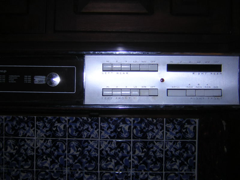

The two front elements (“burners”) on my GE cooktop do not respond to the controls in the control hood. The right rear element will heat only one of the coils. The left rear element works normally. I had a repair tech check the stove and learned that the elements are OK but the controls are not functioning.
So replace the controls. That’s the catch. This control hood/rangetop combination is over 30 years old and parts are not listed. I will need to have parts from a discarded control hood or use substitute parts that will function in place of the originals.
I need controls (switches) for left and right front and right rear elements.
Please, can anyone help me obtain parts for the control hood?
I am attaching photos of 1) the control hood with the switch (control) for the right rear element removed and 2) three views of the switch for the right rear element. Other switches will look similar.

GE switch # WB23X47 is replaced by part # WB23X58 which is discontinued. I’m afraid I do not know where you’ll find old stock of either still kicking around. Sorry.

I haven’t yet ordered the part. As you probably remember we have one heater element fully working and another partly working. (This has been enough stove for us to get by in the hot weather we’ve been having.)
I did remove the partly working switch with the hope that I might be able to repair it but couldn’t get inside to analyze the problem. A friend of mine who does appliance repair suggested I try spraying the switch with some contact cleaner. Since I couldn’t get inside, I sprayed some cleaner through an opening. While that didn’t restore the switch, it did appear to improve the performance somewhat — works on higher heat level. I used CRC Electrical Grade QD Contact Cleaner because that is what was available at Home Depot. (As I recall Radio Shack didn’t have anything suitable and Lowes had nothing)
My current plan is to remove the partly working switch again and swap it with one of the non-functioning switches. If that also swaps which elements work, I’ll order a switch and install it. If that restores operation of its element, I’ll order another switch.
