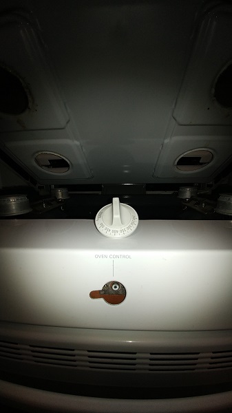

The shaft from the knob to the oven control switch was sheared off accidentally, right at the knob, so some of the shaft is stuck inside the knob. I can’t seem to find a replacement knob and switch.
Can we just use JB Weld or something similar to glue it back together? The oven was off when the shaft was broken, so it’s not hard to match up the pieces.
Do we have to order a new switch instead, if that’s not a reasonable repair process?
Are there matching replacement knobs available for a 20-year-old gas range and oven?

No, it’s not the clock. It’s the oven knob. The knob turns, but doesn’t push in. I’ll try to post a pic, but I haven’t done anything on forums in forever, and I’ve forgotten how.
It must be this part.
GE WB20K8 Oven Thermostat - AppliancePartsPros.com
These 2 pics show the front of the oven, and the knob and where it used to be attached to the rest of the shaft.
Here’s a pic that shows the front of the knob.
