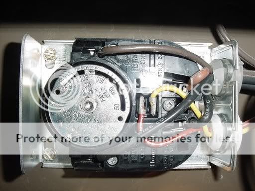

[SIZE=1][SIZE=1]Most older gas furnaces that have standing pilot systems use a thermostat switch located in the hot air plenum that detects when the furnace is hot and turns on the blower.[/SIZE]
[SIZE=1]These thermostats (more commonly called the Fan/Limit control) are usually made by Honeywell or white-Rogers.[/SIZE][SIZE=1] The typical settings for the stops are 70 to 90 “Off”, 130 to 150 “On”, and the “Limit” to the bottom of the slot (lowest setting) as long as you don’t get nuisance shutting off of the fire. As you might guess they also control the gas valve if the furnace gets too hot.[/SIZE]
[SIZE=1]If you have problems with the blower not shutting off, its probably sticking. There made up of bi-metal strips that eventually wear out. They come in different sizes in length. Various from 5", 8", and 11" long. Need to pull your old one out to see what size it is. Here is a picture of your control[/SIZE]

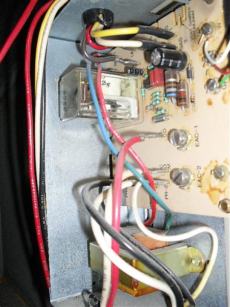

ok, that helps. Your blower is actually controlled from the circuit board with a glass relay. Alot of the older ones, u can actually unplug the glass relay from the circuit board.
Turn off the 120v breaker to the furnace and remove the metal cover over the control board and you should see the relay. If it’s glass (you can see through it), should be able to unplug it from the board and just replace it.
If it’s small and black however, you will have to replace the entire control board, since this type will not unplug from the board.
Maybe remove cover and take a pic of that. Hopefully you have a glass relay since this is somewhat cheaper route than replacing the entire board.

First, thank you for your time and help. Attached are the photos you requested and if I am interpreting what I see correctly, there is indeed the relay which you described. If that is indeed the case, could you steer me in the direction of where to get a replacement?

I thought that looked like a Bryant control board before you took the cover off..lol.. good pics. That relay will not unplug, so you will have to replace the board.

Knowing this, you should be ok to change out the control board. Here is a link from carrier itself i found.

How fortuitous that you posted when you did beacuse I just finished installing the new circuit board. I labeled each wire using a small peice of tape before I removed it from the old board. It took a bit of coaxing to pull the wire off the old board but the rest of the job went smooth. I just completed running a test and everything works as it should.
