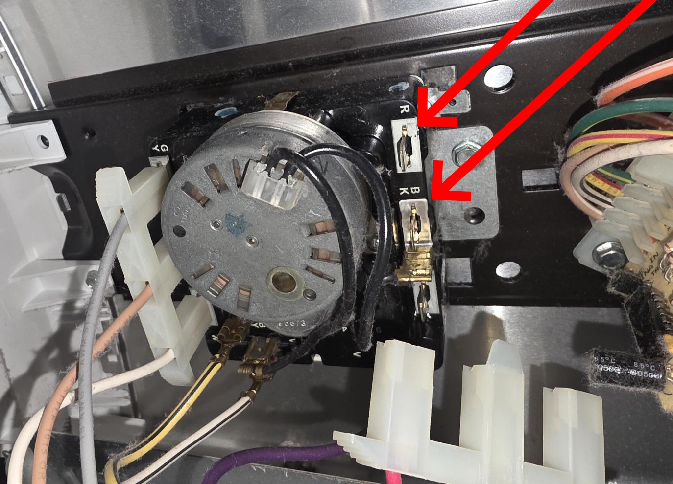

Is there continuity at the timer from terminal BK to terminal R with the red wire disconnected?
WilliamM_APP_Team, thank you for the very clear directions.
Dryer unplugged. I disconnected the connector as shown to reveal the two terminals (red arrows), and tested multiple times to confirm no, there is not any continuity between terminal BK to terminal R.
Does it gain continuity if set to a normal cycle? If not, the timer has failed. WP3976576 Timer | Genuine Whirlpool OEM In Stock

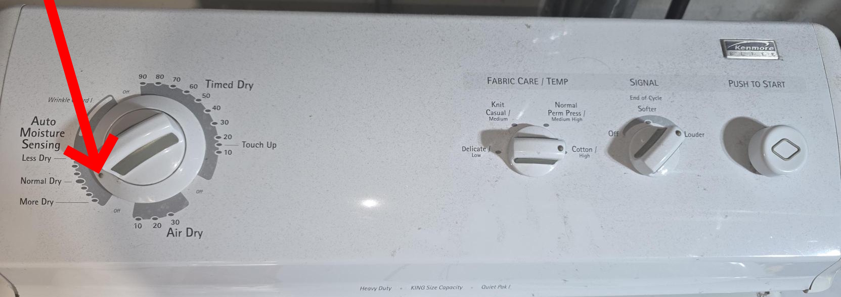

Yes, it gains continuity when the Time knob is set to a normal cycle, as shown.

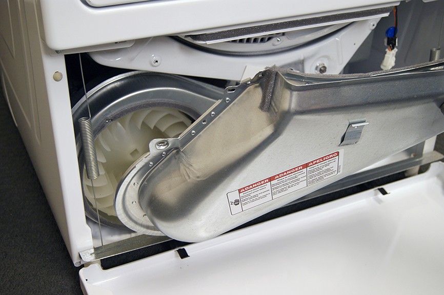

During my first test after replacing the igniter, I tested
without reinstalling the Lint Duct Assembly/cover - image below -
or putting any clothes in dryer: igniter glowed, burner fired, and I watched until burner stopped.
Could running without cover have caused my current ‘burner fires only initially, but not as needed after cycle cools’ problem?
