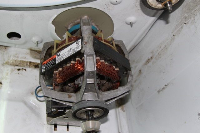

Update 3. Picture added of motor location. I didn’t remember taking pictures last time when I replaced the coils but I’m hoping someone recognizes this setup and might point me to a manual or maybe provide some instructions on how to work on this thing.
The coils were relatively easy to replace once they were determined to be the problem but this thing looks like it has to be accessed from the front and as you can see, it sits all the way to the back.
If an other photos or information is needed, please let me know. I’m in the process of pulling the front end off again. Thanks!

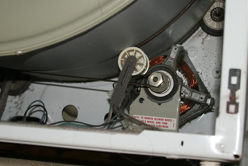

OK. The front is off again and everything looks just like the picture. First thing I checked is the belt and when the drum is centered, I would say the belt is a little loose.
Then I checked the front part of the motor you see in the picture. To check it, I first lifted the drum up so that there is no tension from the belt at the point of the front and tried to turn the armature using the motor shaft.
From the front I could barely get the armature to turn, but it did turn some. Then I checked the back of the armature where the fins are. I turned the fins in both directions with relatively easy force.
I don’t have a manual but it looks like the front part of the armature is supported by some bearings. Would it be possible to replace those bearings? Or is it just as much work to replace the whole motor?

OK. The motor is toast! I decided I need to replace it, however, separating the motor armature rod from the blower seems to be a trick. I have removed the front and rear clips holding the motor down to the base bracket. Then I removed the base bracket out of the way, too.
The blower fan sits on the other side of the housing, inside the blower enclosure which is held in place by 3 screws. However, to remove the screws holding the blower housing in place, you must first remove the blower fan to get to them. I can’t remove the fan from the outside and the motor will not pull away from the inside.
Any ideas? What am I missing here?

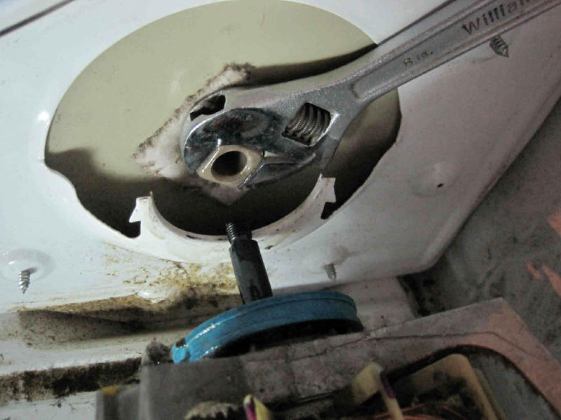

OK! It unscrews BUT “left hand thread” so it unscrews in the direction you would normally screw something on. So, you turn CLOCKWISE to loosen!!! DUH!!! I posted another pic. This one shows how to unscrew the blower fan from the motor armature rod. In the pic, the motor base plate has been removed already. I learned later that it wasn’t necessary to remove the base plate.
NOTE: The blower fan is made of plastic and it is screwed onto a metal rod, so I sprayed some Break Away (GREAT STUFF) and waited about 30 minutes before trying.
I positioned a smaller adjustable wrench as close as possible against the back wall and made sure to tighten the wrench as snug as possible onto the fan. Since I am turning CLOCKWISE to loosen, I laid the end of the adjustable against the side of the cabinet to lock it in place.
I used a larger adjustable (the one that is turned CLOCKWISE) on the other end of the armature rod and gave a firm CLOCKWISE turn. It was either going to break or break free.
SUCCESS!! I don’t know if it was the Break Away or not, but after it broke free, it screwed off CLOCKWISE easily the rest of the way.
Now to order a new motor from Appliance Pros and I’ll try to follow up after installing the new motor. But if I do not make it back here, installation is in the reverse order. So, you would turn the motor armature rod COUNTER CLOCKWISE, in the same direction you would normally loosen something, to tighten the blower fan back on.
DO NOT OVER TIGHTEN because you are screwing a metal rod onto a plastic fan. The normal operation of the dryer will keep the fan tight.

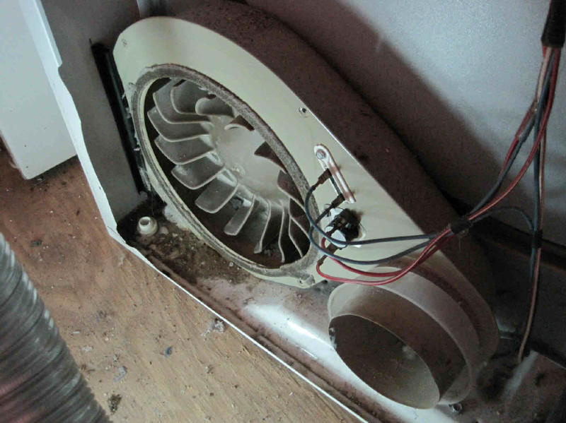

Just wanted to add some pics to finish this thread. The adjustable wrench along the back wall holds the fan from turning. Use the adjustable on the front of the motor shaft to turn CLOCKWISE to loosen the shaft. Spray a little breakaway a few minutes before and keep your fingers crossed that the fan doesn’t break when you first break it loose. (I have read on this forum that it’s normal for them to seize and usually break when trying to remove - metal on plastic).
Anyway, once the shaft is unscrewed from the fan, get the motor out of the way. Note that you will have to remove the duct on the back of the dryer to access to fan. However, if the motor comes off cleanly like mine did, you might be able to replace the motor without doing all of that. I removed it because I was concerned about a buildup of lint at the bottom of the fan housing.
Assemble in the reverse order and DO NOT OVER TIGHTEN the new motor shaft to the fan. Because the fan has a “left-hand” thread, the normal direction of spin keeps the shaft from unscrewing from the fan.
