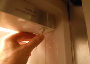

ok, so i assume the the fresh food light is what is in the picture below, correct? I just want to make sure because I have done what the instructions say, depress five times in six seconds and nothing happens. The fans and compressor do not shut off. I just want to make sure I am doing it correctly. The digital display in the fresh food section still has numbers displayed. I have read some places that in manual defrost mode these will say “d” and “f” or something. Not sure if I am doing something wrong or this means there is another problem.
As long as this is the switch which turns the light off/on in the fresh food section then it is the correct switch.
