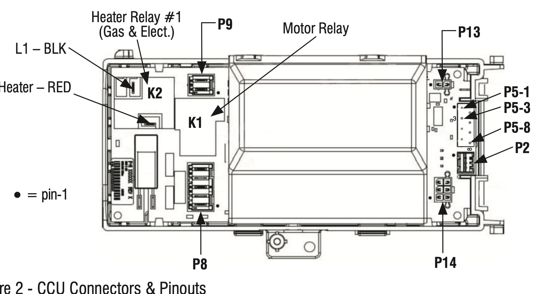

Make sure the polarity on element wires that are correct to relay
on the board on the relay K2 Just like in this screen shot. Red at bottom.
Also motor circuit: Black to P9-2
P9 is probably a molex plug so you probably could not wire that wrong.These dryers are polarity sensitive.
Thanks, I double checked both of those connections and they are correct. I took pictures of the factory wiring the first time I opened it up so I’m (95%) confident I have reconnected things as they were.

The only way the control can tell if L2 is present is if voltage is passing through the element. But if the motor isn’t running, L2 never makes it through to the element—because the motor’s rotation is what controls that L2 feed.
Here’s a way to check if the motor is the issue:
  1. With the unit powered on but the motor stopped, access the main control.
  2. Set your multimeter to VAC.
  3. Test between the light blue wire at P9 pin 1 and the white wire at P8 pin 3.
  • If you see 120 VAC, the control is sending voltage to the motor. The only things that could block it are the thermal fuse or the belt switch. Since both of those are “all-or-nothing” parts and your motor does run sometimes, they’re not the culprit.
  • If voltage is there but the motor won’t run until the dryer cools down, then the motor’s internal overload is tripping. That can be caused by a worn motor or even a big gap in a felt seal letting heat escape and overworking it.

What voltage reading was found based on the testing information? The voltage reading will identify which direction of testing would need to be done for the motor not starting.
As instructed, I connected a multimeter to the light blue wire at P9 pin 1 and the white wire at P8 pin 3, and waited for the dryer to shut off mid-cycle. The meter continued to show 120VAC even after the dryer shut off, so this confirms that the motor overload is tripping.
