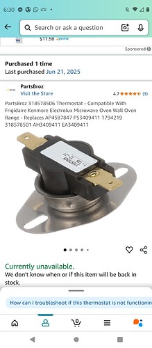

PartsBroz 318578506 Thermostat -… Amazon.com
That’s the part I ordered and it solved our problem. The exact same you have. We received the part today, my husband installed it and our oven is now working after months trying to find the solution. Yes!!!
I hope it helps you all!
