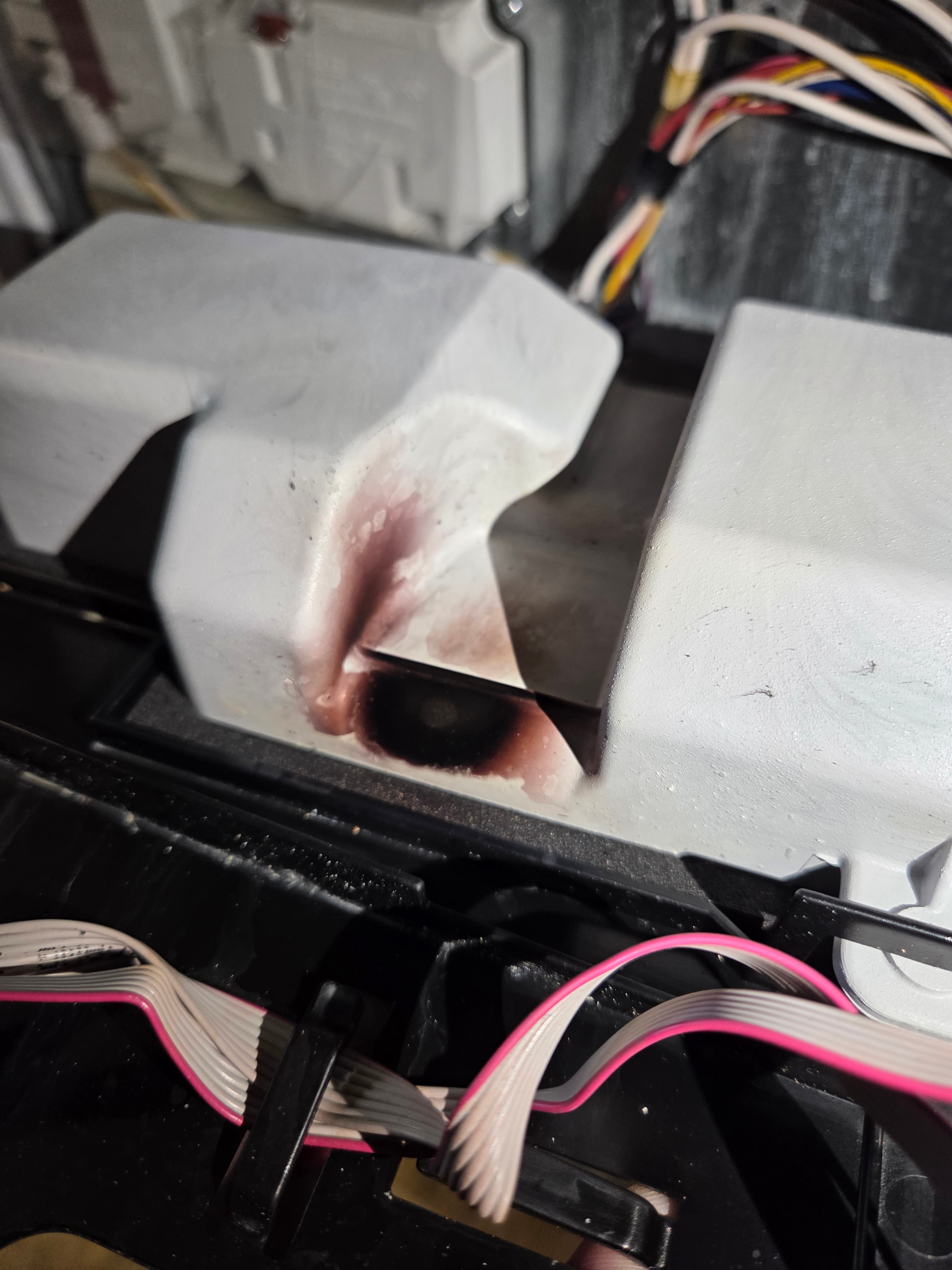

Frigidaire LFID2426TF2A dishwasher immediately tripping breaker
Brand: Firgidaire
Model Number: LFID2426TF2A
Main Symptom: Stopped mid-cycle, left water in tub, now pops breaker immediately
What happens & when: Turn the breaker on, there is a popping sound coming from inside the dishwasher door (near the top of the door)
It sounds like the control may have a short or there might be a damaged wire. If you turn the breaker off and remove the outer door panel, there should be signs of arcing to identify where the issue is happening. A11147301 Main Control Board | Genuine Frigidaire OEM In Stock
There were definitely signs of arching,
although I’m unsure of what to replace at this point. If you would, please advise accordingly. Thank you!
From what I can see, it looks like the main harness and the door latch may need to be replaced. It does not look like the main control has been damaged, but it is a possibility.
Main harness- 5304506794 Dishwasher Main Wire Harness | Genuine Frigidaire OEM In Stock
Door latch- 5304525218 Dishwasher Door Latch Assembly | Genuine Frigidaire OEM In Stock
Main control- A11147301 Dishwasher Main Control Board | Genuine Frigidaire OEM In Stock
