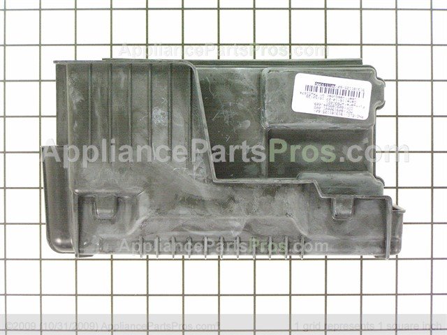

Step 3.) Access the clutch, pt# AP7225294.

Step 8.) If the above resistance is found, access the main control board, pt# AP6261755.

Step 12.) If the resistance is not consistent through the harness to the main board, replace the harness, pt# AP5971684.
Step 13.) If the resistance is consistent, replace the main control board.
