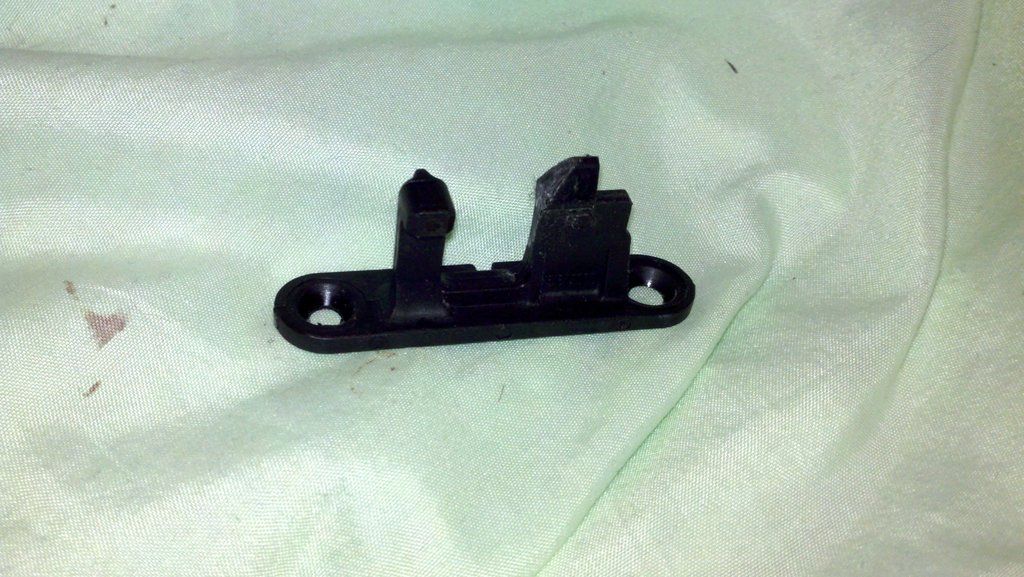

Here is the striker that I have:
  • Justin
Looks like this is the same part (#14 at the diagram).

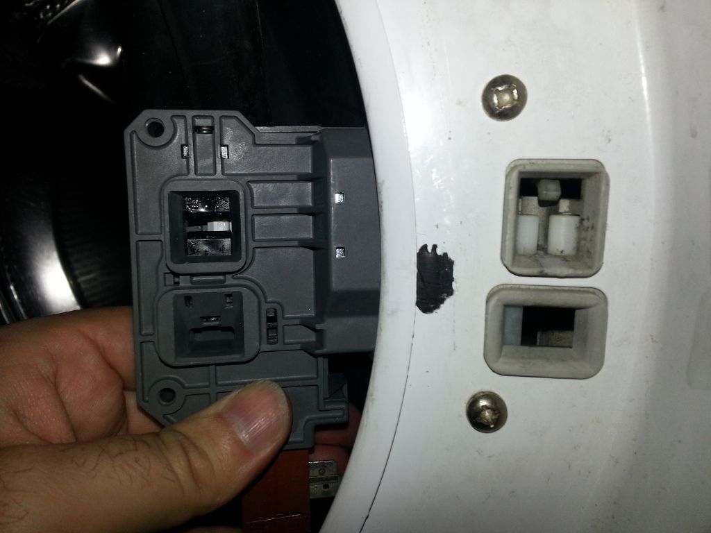

Well, I finally got around to replacing my lock switch. Took the top off of the washer and pulled the door seal back to allow access to the switch, and while doing so I realized first that the wiring is different between the original switch and the replacement. I compared the part I received to the pics here, and it’s definitely the same, but the original uses a completely different plug setup.
The other problem with it is that the striker doesn’t fit it. Again, looks like the replacement is a different design as the original.
Here’s the original (still installed) and the replacement in my hand:
My striker not fitting into the lock mechanisims of the replacement switch:
Not sure what to do about this? I am guessing that maybe the other striker that seems to be available for this model (the white one I mentioned above) fits this replacement switch, but what are we expected to do about the wiring?

After more researches I found that Frigidaire has redesigned the striker for this model as well. The original part number 131279000 has been changed to 131279001. On the pictures they look very similar with the same color but their sizes probably a bit different.
Regarding the wiring: click on the door latch assembly part number in my previous post, scroll down to the Q&A section and click on the Read all questions link. Scroll down to the 9th question and read the answer posted for Tony. I believe that’s what you are looking for.

Thanks so much for the response. After reading that Q&A and looking at the wires on my old lock switch I understand exactly how it should be wired up.
As far as the striker goes, I’m not sure what the deal is with the new part number, but if you click that link to the new striker part number, the picture is of the old part (131279000). However, I noticed after looking at the description of the replacement lock switch it says : “Front load door lock and switch assembly. For door striker order 131763310.” So I guess I’ll have to order the replacement striker after all, but that’s no big deal.
