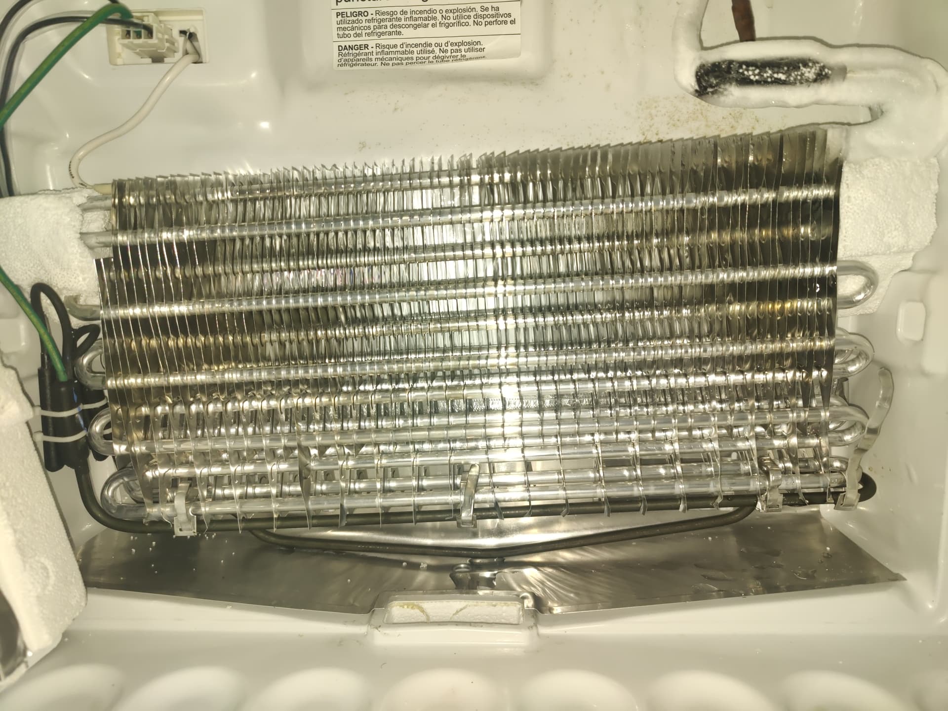

You will want to check to see what the evaporator coil looks like. If the picture is showing what they look like when the unit is running and there is no frost except what is at the top right then this will be a sealed system issue. With a sealed system issue, you will need to have service out to repair the unit.
Thank you for your answer. I took the picture after defrosting and letting the fridge running for a few hours, but if I give it a few days, the whole surface will get even with frost/ice (it was like this too before I swapped the eveporator). Unfortunately it made no difference apart of actually heating up. Could it be an improper installation?

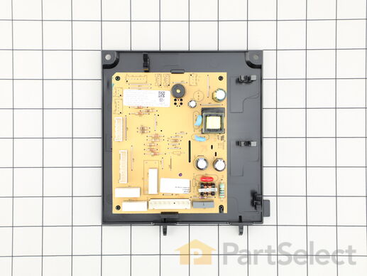

Ok so in this case since the heater has already been replaced and it has the defrost thermostat/thermistor on it then the control board will be the issue.
By board do you mean this part? It’s located at the bottom of the fridge (back)
Yes, that would be correct
Okay I will check when I can, never thought it could be the issue.

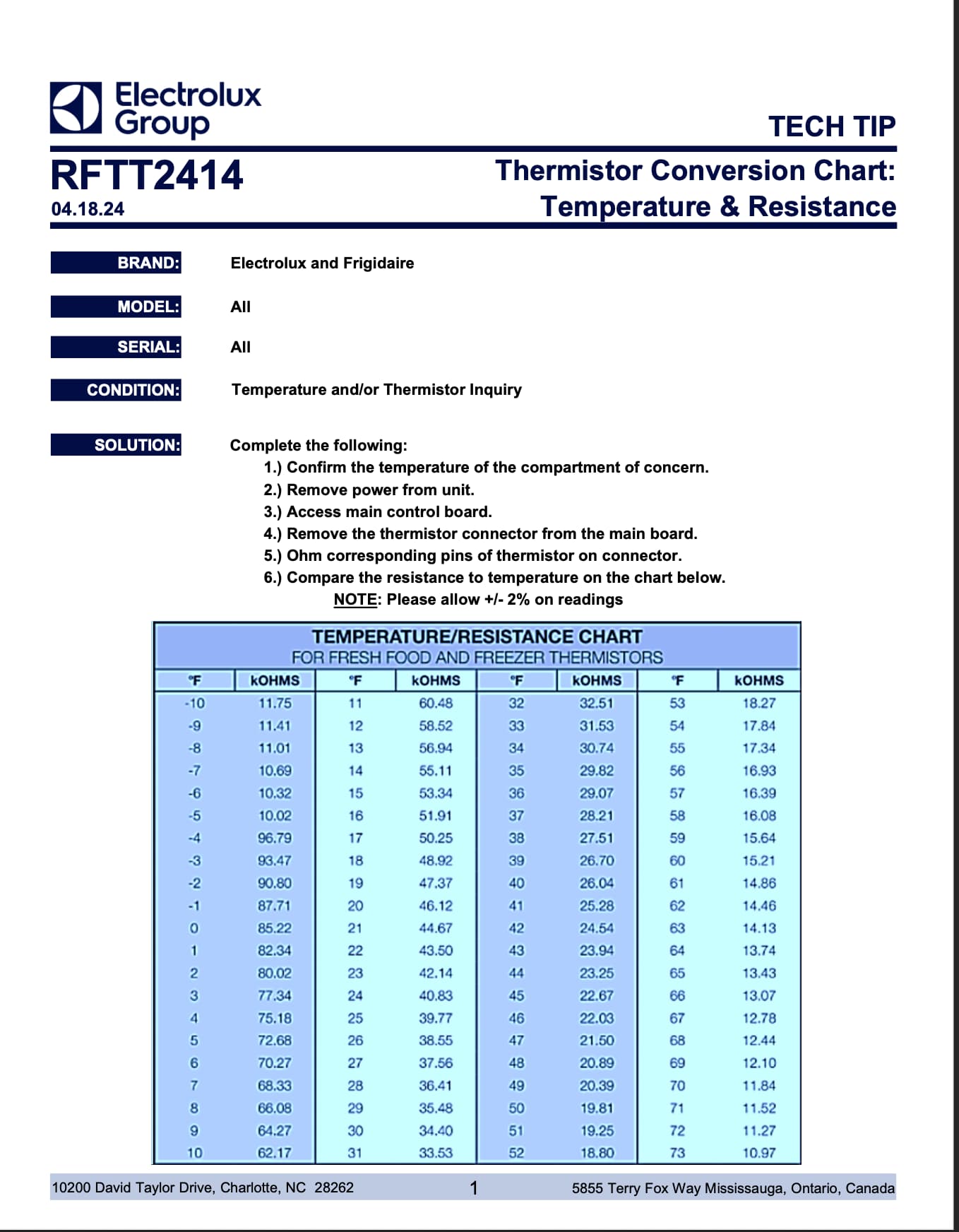

This is the valve of the thermistor at different temperatures This is a very common problem with this refrigerator !
Thank you! I’ll check it out as well as soon as I can

So I checked and I get no readings for the termostat (but i’m not sure I’m testing this correctly). Another symptom I found out today is I brought down the freezer temp at 46F and the fan stops working, certainly a sensor issue like you suggested.
