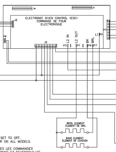

Frigidaire FPCF3091LFA broiler comes on when bake is selected
Brand: Frigidaire
Model Number:FPCF3091LFA
Main Symptom: broiler always on
What happens & when: always
Error Code (if any): none
My oven turns on the broiler when bake is selected. I don’t believe this is a preheat situation. My research tells me that this is likely a stuck relay on the control board. I’d like to understand if that’s the case and, if so, which board I need.
How do I confirm and which P/N do I need?

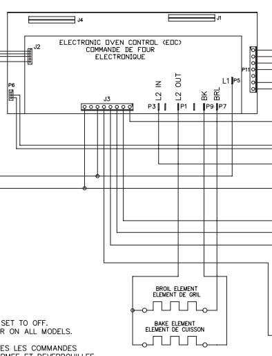

The main board is 316560112. If the broil relay is stuck you should have about 120v AC from P7 to Ground or Neutral even if a heating cycle hasn’t been started.
https://www.appliancepartspros.com/frigidaire-controller-316560112-ap4565979.html
Yep, 120v at P7. I’ve ordered a main board from you guys, thanks.
