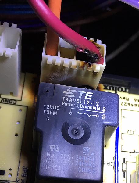

Gene, this is the LGEF3045KFK model. I am reading this could be as simple as it being the overlay. The day this started I had a pan boiling on a front burner. Wondering if it could have overheated the overlay or even gotten moisture inside.
I have taken the EOC off and see what I think is the problem. So I guess the questions are,why did this happen and where do I go from here.

  1. Why?
    Most likely the cause of the problem is a faulty relay.
  2. What to do?
You would need to replace the EOC and the plug. You also may want to order the new overlay as well due to possible damage to the old one during the reinstallation. The worst part is that the manufacturer does not sell separate plugs. You would need to order the whole main wiring harness and splice in the needed plugs.
The EOC comes as a kit with some filter and installation instructions. The EOC kit AP5807223
The main wiring harness AP4319407
The overlay AP4433205

This repair went well. Replaced the EOC and overlay, applied all the plugs and wires from the old EOC to the new, except for the burned plug. Used the new plug and its wires from the new wiring harness. No problems when powered back up.
You are welcome. The relay is a part of the EOC so the new EOC comes with all new relays.
