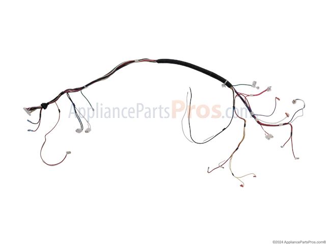

The only 2 things really involved with the dispenser are the dispenser assembly 5304532199 itself and the main control board 5304529215. Since the dispenser has been replaced I would suspect the control board. The only other thing is possibly an issue with the main wiring harness 5304504853, I’d split the door and check it for any damage or corrosion on the connectors.
Thanks Rory D. I was so proud of myself for about 4 days. I’ll crack the door open and check the connections and report back.
