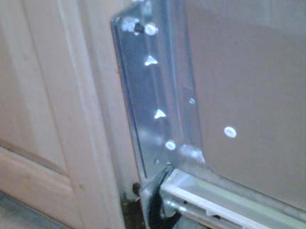

I have figured out how to replace the gasket – I took a few pics along the way.
  1. remove the front panel (there are two screws needed for this):
The front panel now slides down and off, no other srews are needed on this side.
  1. remove lower dish rack (I neglected this step, I wish I had since it will give you more room to work)
  2. remove one of two hinge screws (this seemed like a good idea to allow the door to swivel and not have to disconnect any wires)
    Just the bottom screw of the two (both sides).
  3. swivel the door to give you better access (or course you can skip all this nonsense if you have small/nimble hands – I don’t)

remove front panel.jpg (10.6 KB)
door hinge.jpg (9.4 KB)
